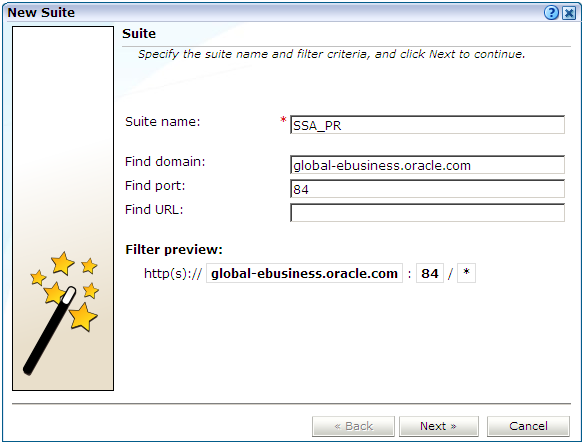

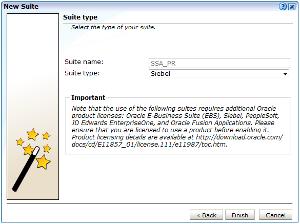

To define a suite instance, do the following:
  1. Select Configuration, then Applications, and then Suites from the menu structure shown in Figure 10-1.
  2. Click New suite. The dialog shown in Figure 10-2 appears.
  3. Specify a name for the suite. The name must be unique across suites, services, SSO profiles, and applications. Note that suite instances cannot be renamed later.
  4. Use the remaining fields to specify the scope of the suite. This is defined in terms of partial page URLs. The use of these filter criteria is the same as described in Section 8.2, "Defining Applications". Note that as you enter this information, you can see the effect of your definition through the Filter preview column. The use of blank filters is not permitted. Note that a wildcard character (*) cannot be specified within the Find port field, and network traffic arriving on a non-standard port (that is, ports 80/443), is not associated with the suite instance. Only one port number can be explicitly specified. If more are required, they should be configured as additional filters. Note it is not possible to specify the wildcard character and no other information for domain name and URL argument combinations. When ready, click Next. The dialog shown in Figure 10-3 appears.
    It is advised that filter definitions should be mutually exclusive across suites, SSO profiles, applications, and services. The use of non-mutually exclusive filter definitions can lead to unpredictable results. See Section 12.9, "Controlling Rule Ordering Within RUEI" for more information about how you can control the order in which filters are applied.
  5. This dialog allows you to specify the Oracle Enterprise architecture upon which the suite is based. When ready, click Finish. The suite definition you have specified is displayed. An example is shown in Figure 10-4.

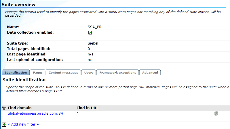

    Figure 10-4 Suite Overview
    suite overview
  6. This overview provides a summary of the defined suite. This includes the defined page identification filter(s), the total number of pages seen (since 0:00 current day), the functional errors (if any) that should be detected and recorded, and the user identification mechanism used within the suite to track visitor sessions. Each of these can be modified as required. The procedure is equivalent to that described in Section 8.2, "Defining Applications".

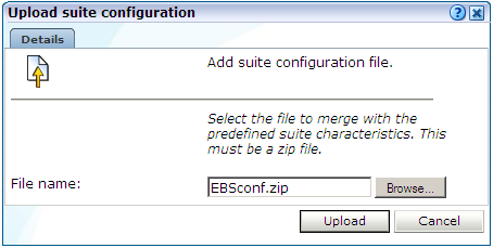

  3. Create a .zip file from the generated .txt files, and copy this .zip file to a location that can be used for uploading files to the RUEI Reporter System.
  4. Select Configuration, then Applications, then Suites, and select the appropriate suite. An overview of the suite appears. Click the Upload configuration command button. The dialog shown in Figure 10-5 appears.
    Figure 10-5 Upload Suite Configuration
    Description of Figure 10-5 follows
    Description of "Figure 10-5 Upload Suite Configuration"
  5. Specify the name of the file generated by the script. A Browse button is available to help you locate the required file. This must be a .zip file. When ready, click Upload.
Important:
This configuration file must be uploaded for each required suite instance. It may only contain known (and non-empty) .txt files. All these files must be in the root directory. That is, subdirectories are not permitted. It is important you upload the correct configuration file for the required suite instance, and that it is based on the actual production environment. If you make any changes to the monitored application(s), you need to re-run the script, and re-import the generated .zip file.The result of importing an erroneous configuration file is incorrect reporting.

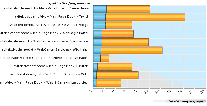

10.1.4 Verifying and Evaluating Your Suite Definitions
To ensure the quality of the data being collected and reported by RUEI for your Oracle Enterprise architecture-based applications, it is strongly recommended you verify their reported details. You should pay particular attention to the number of associated pages detected for the defined suite(s).
Select Browse data, then select the All pages group, and then the Applications sub-group. Within the individual dimensions, such as Page views and hits, you can see page views are reported for several applications. The suite name in the definition is shown between brackets. The example shown in Figure 10-6 is for a WLP streaming portal.
Figure 10-6 Suite Page Views
Description of Figure 10-6 follows
Description of "Figure 10-6 Suite Page Views"

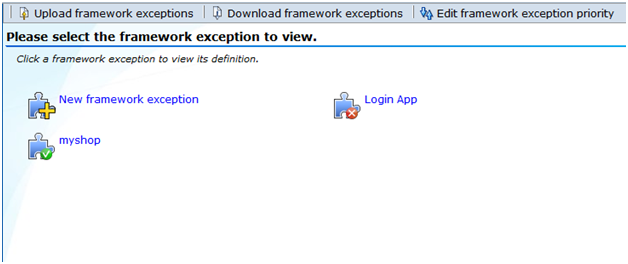

  1. Select Configuration, then Applications, and then Framework exceptions. Click the New framework exception item. The dialog shown in Figure 10-8 appears.

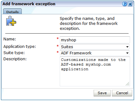

  2. Specify a unique name for the framework exception. Select "Generic" if the framework exception applies to all application definitions, or "Suites" if it only applies to a specific Oracle Enterprise architecture. In the case of the latter, you will need to specify the architecture. Note that suites only appear in the Suites type menu if at least one suite instance of it has been defined. Optionally, specify a brief description. It is recommended that it includes an indication of the purpose and scope of the defined exceptions. When ready, click Save.

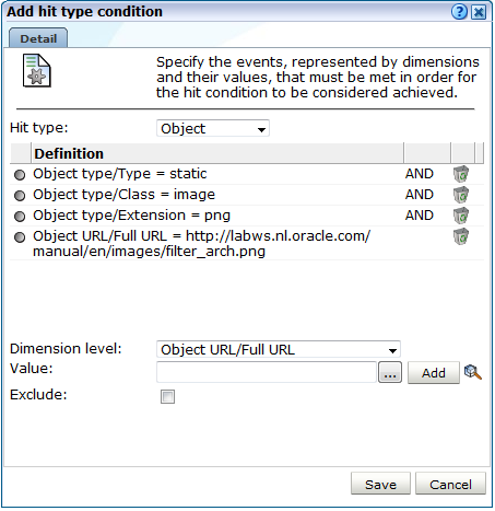

  5. Click the Page/object conditions tab. Click the Add new condition item. The dialog shown in Figure 10-10 appears.
    Figure 10-10 Add Hit Type Condition Dialog
    Description of Figure 10-10 follows
    Description of "Figure 10-10 Add Hit Type Condition Dialog"
  6. Use the Hit type menu to specify how detected hits should be treated. The available options are shown in Table 10-1.
    Table 10-1 Hit Type Options
    Hit type Page nameFoot 1  Loading timeFoot 2  Content errorFoot 3  PreviewFoot 4
    Page
    X
    X
    X
    X
    Object
    X
    Redirect
    X
    Heartbeat
    Footnote 1 The reported page name is derived from the hit.
    Footnote 2 Hit taken into account when determining page-load time.
    Footnote 3 Hit is scanned for content errors.
    Footnote 4 Used for previewing in the Session Diagnostics feature.
    Specify the events that must be met for the exception to be applied. For each event, use the Dimension level and Value menus to select the dimension that should be checked, and the value that it must hold. Note that if the required value is not available within the Value menu, you can click the Search icon beside it to locate it.
    Optionally, use the Exclude check box to specify that the defined dimension level=value pair should be negatively applied. That is, the event should be regarded as achieved if the defined event is not met. When ready, click Add. Note that while only one defined condition needs to be achieved in order for the exception to be applied, all events within a condition must be met for it to be considered achieved. When ready, click Save. You are returned to the dialog shown in Figure 10-9.

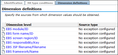

  7. Click the Dimensions definitions tab. A list of dimensions specific to the selected application type is displayed. An example is shown in Figure 10-11.
    Figure 10-11 Dimension Definitions Section
    Description of Figure 10-11 follows
    Description of "Figure 10-11 Dimension Definitions Section"

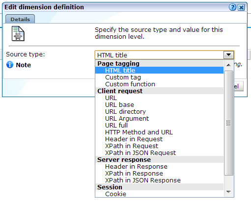

  8. Click the dimension whose default source you want to modify. Use the Source type and Source value fields to specify how the selected dimension's reported values should be derived, see Figure 10-12.
    Figure 10-12 Source Type Options
    source type framework exceptions
    Optionally, you can use the Replace value field to specify a transformation that should be applied to the retrieved value. The available options are explained in Table 10-2. When ready, click Save.
    Table 10-2 Identification Options
    Option Description
    URL argument
    The dimension value should be derived from a specified URL argument.
    XPath in request
    The dimension value should be derived from an XPath expression applied to the request.
    XPath in JSON request
    The dimension value should be derived from an XPath expression applied to the JSON request.
    Header in request
    The dimension value should be derived from a specified request header.
    XPath in response
    The dimension value should be derived from an XPath expression applied to the response.
    XPath in JSON response
    The dimension value should be derived from an XPath expression applied to the JSON response.
    Header in response
    The dimension value should be derived from a specified response header.
    Cookie
    The dimension value should be derived from a specified cookie element.
    Custom tag
    The dimension value should be derived from a specified custom tag.
    Custom function
    The dimension value should be derived from a specified custom function. Note that only the first parameter is used, and it must be enclosed in single or double quotes. For example:
    wiViewState("wi_menu_main_menu");
    Literal value
    The dimension value should be set to a specified literal value.
    HTML title
    The dimension value should be derived from the text found within the page's <title> tag
    URL
    The dimension value should be derived from the complete domain and URL as it appears in the visitor browser location bar.
    URL base
    The dimension value should be derived from the main directory and file name (without the file extension) parts of the URL.
    URL directory
    The dimension value should be derived from the directory part of the URL.
    URL full
    The dimension value should be derived from the main directory, the file name (without the file extension), and the configured arguments within the URL.

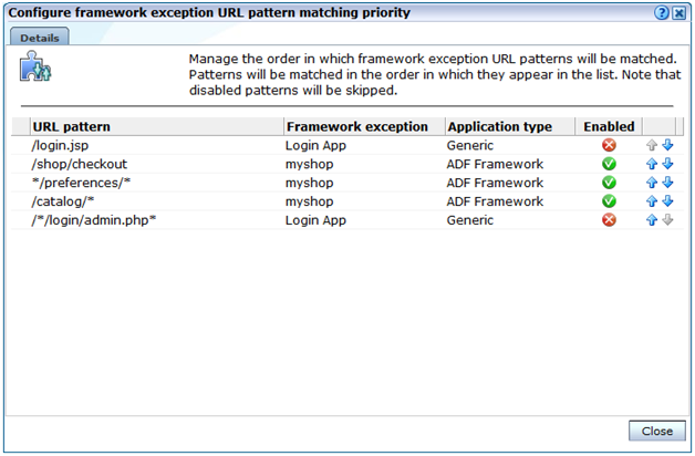

10.2.1 URL pattern evaluation order
By default, the order in which individual URL patterns are evaluated is the order in which they were defined in the system. In other words, each new URL pattern that you define would be placed at the bottom of the pattern evaluation chain. During processing, RUEI will try to match an URL against the available patterns in that sequence.
There are cases in which you might need to change the evaluation priority of one or more URL patterns. For example, if a pattern contains a high level of detail so that it narrowly identifies a specific URL, e.g. /shop/checkout/payment-failed.jsp, it would need to be evaluated before a more generic expression, such as /shop/*.
RUEI provides you with the facility to manage the evaluation priority of the URL patterns. In the framework exceptions overview screen, click the "Edit framework exception priority" button in the toolbar.
Figure 10-13 Framework Exceptions Window
The following dialog appears:
Figure 10-14 Framework Exception Priority Window
This dialog presents an overview of all framework exception URL patterns, in the order in which they will be evaluated (patterns at the top of the chain will be evaluated before patterns at the bottom).
The first column contains the URL pattern. The second shows the framework exception for which this pattern was defined. The third column identifies the type of the framework exception (this is the type specified during the creation of the framework exception). The fourth column shows whether the framework exception is currently enabled. (Note that URL patterns for disabled framework exceptions will be skipped during URL matching, regardless of their position in the matching priority chain.)
The final column contains the controls that let you move patterns up and down the chain. Clicking on an "Up" arrow will move the current URL pattern up by one row thereby increasing its matching priority. Clicking on the "Down" arrow will move the current URL pattern down by one row, decreasing its matching priority. Note that changes become effective immediately.
Click the "Close" button when you are done.

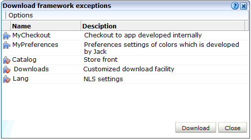

Downloading Framework Exception Definitions
To download a defined framework exception, do the following:
  1. Select Configuration, then Applications, and then Framework exceptions. Click the Download framework exceptions command button. A window opens showing the currently defined framework exceptions. An example is shown in Figure 10-15.
    Figure 10-15 Download Framework Exceptions Window
    Description of Figure 10-15 follows
    Description of "Figure 10-15 Download Framework Exceptions Window"
  2. Select the required framework exceptions. When ready, click Download.
  3. Depending on how your browser is configured, you are either prompted to specify the location to which the zip file should be saved, or it is immediately saved to the defined default location.

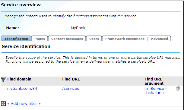

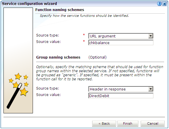

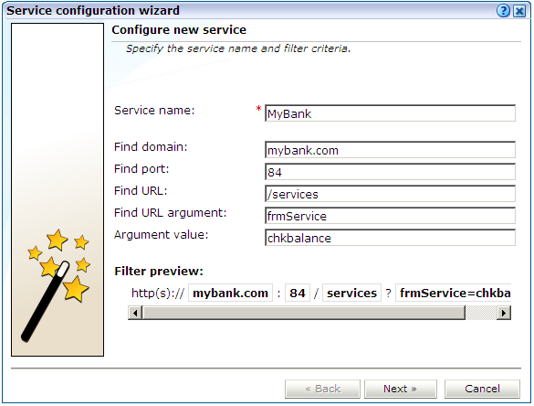

  1. Select Configuration, and then Services. The currently defined web services are listed. Click New services. The dialog shown in Figure 10-16 appears.
    Figure 10-16 Service Configuration Wizard
    Description of Figure 10-16 follows
    Description of "Figure 10-16 Service Configuration Wizard"
  2. Specify a name for the service. This is the name that will be used for the defined service within reports and the Data Browser. The name must be unique across services, SSO profiles, suites, and applications. Note that services cannot be renamed later.
  3. Use the remaining fields to specify the scope of the service. This is defined in terms of partial service URLs. Note that as you enter this information, you can see the effect of your definition through the Filter preview column.
    The highest level filter is the domain. You can specify a partial URL instead of, or to refine, a domain. It is not possible to specify a service name and leave all the other fields blank. Note that a wildcard character (*) cannot specified within the Find Port field, and network traffic arriving on a non-standard port (that is, other than ports 80/443), is not associated with the service unless the port number is explicitly stated. You can only specify one port number within the Find Port field. If you want to specify additional ports, these should be specified as additional filters after the new service has been created.
    Be aware that while the use of a wildcard character is supported, all other specified characters are interpreted as literals. Note it is not possible to specify the wildcard character and no other information for domain and URL argument combinations.
    It is recommended that filter definitions should be mutually exclusive across services, SSO profiles, applications, and suites. For example, do not define a service filtered on the domain us.oracle.com and then another service, suite, or application filtered on us.oracle.com/application_servlet. The use of non-mutually exclusive filter definitions can lead to unpredictable results. See Section 12.9, "Controlling Rule Ordering Within RUEI" for information about how you can influence the order in which filters are applied.
    You can also specify an argument within the partial URL that must be matched. Note that if you use this facility, both the argument and argument name must be complete in order for them to be matched to page URLs. That is, partial matching is not supported. When ready, click Next. The dialog shown in Figure 10-17 appears.
    Figure 10-17 Function Naming Scheme Dialog
    Description of Figure 10-17 follows
    Description of "Figure 10-17 Function Naming Scheme Dialog"
  4. Use this dialog to specify how the service should be identified and reported. It is important to understand that while applications (see Section 8.2, "Defining Applications") have the structure application » group » page, services have the structure service name » function group » function name. If you specify a group naming scheme, this must be found within the function call for it to be reported.
    When ready, click Finish. An overview of the service definition you have specified is displayed. An example is shown in Figure 10-18.
    Figure 10-18 Service Overview
    Description of Figure 10-18 follows
    Description of "Figure 10-18 Service Overview"
Refining Your Service Definitions
Once you have defined your service, you can modify its associated function scheme. Within the Identification section, you can click Add new filter to specify additional filters for the functions that should be associated with the service. A function will be assigned to a service when one of the defined filters is matched. You can also modify an existing filter definition by clicking it. In each case, you can select from the same filters as shown in Figure 10-16. The service overview is updated to reflect your additions or modifications.
