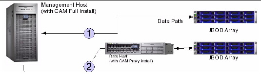

This option installs all core packages on a data host attached to the array for management of storage expansion (i.e., JBOD) arrays. This option includes:
With this option, a host can act as a proxy for the management host (this allows aggregation of information from multiple hosts as well as delegation to other hosts for firmware upgrades, and access configuration changes).
For each Storage Expansion Array (i.e., JBOD) to be managed, the Data Host Proxy Agent must be installed on each data host that accesses the device.
FIGURE 3-1 Data Host Proxy Agent Monitoring JBOD Arrays
| Full (typical) array management software installed on management host with in-band management connection | |
| Data host proxy agent installed on data host with in-band management connection |

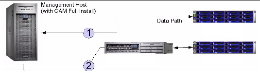

This feature bundle installs a thin scripting client that connects via secure HTTP (HTTPS) to the management host (CLI only). The remote command-line interface (CLI) is used to communicate with a host that has Sun Storage Common Array Manager core software installed.
You can also manage and configure storage using the CLI. The CLI provides the same control and monitoring capability as the web browser, and it is scriptable for running frequently performed tasks.
FIGURE 3-2 Administrator Host CLI Client
| Full (typical) array management software installed on management host | |
The CLI is available by telnetting to the management host or from a remote CLI client that you install on the remote host. It is available for Solaris OS, Windows, Linux, and several other operating systems. See the Sun Storage Common Array Manager Software Release Notes for a list of supported operating system platforms.
For more information about CLI commands, see the sscs man page and the Sun Storage Common Array Manager CLI Guide.
