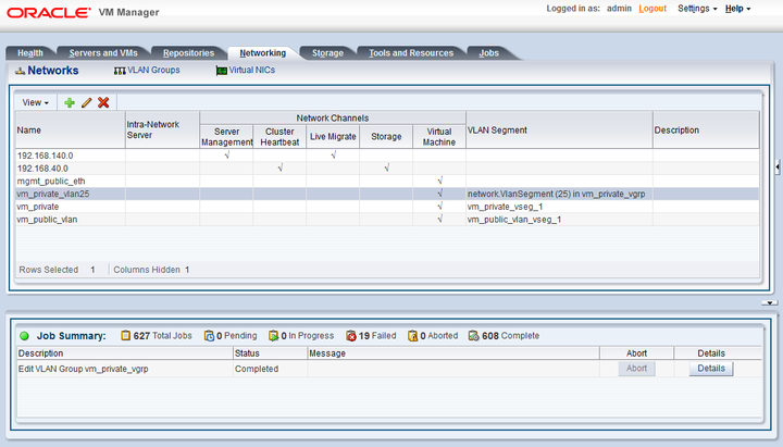

The Networking tab is used to manage networks within the Oracle VM environment running on the Oracle Virtual Compute Appliance. By default, the following networks are already defined and must not be altered:

Additionally, three networks are listed with the VM Network role:
vm_public_vlan
This default network is the standard choice for virtual
machines requiring external network connectivity. It uses VLAN
1 from the VLAN Group named
vm_public_vlan_vgrp
. To use the VLANs of
your choice configure them as follows:
Add the tags or IDs to the VLAN Group
vm_public_vlan_vgrp
The process for editing VLAN Groups is described in the Oracle VM User's Guide in the section entitled Editing a VLAN Group.
Create a new VLAN-only network with the VM
role for each VLAN tag you added to the VLAN
Group. Each new network should be configured like the
vm_public_vlan
network, but with a
different VLAN segment.
The process for creating VLAN-only networks is described in the Oracle VM User's Guide in the section entitled Creating a Network.
Configure your data center network accordingly.
For details, see Section 6.3, “Configuring Data Center Switches for VLAN Traffic”.
vm_private
This default network is intended for virtual machines
requiring network connectivity to other virtual machines
hosted on the appliance, but not external
to the appliance. It uses VLAN 1 from the VLAN Group named
vm_private_vgrp
. To use the VLANs of your
vm_private_vgrp
vm_private
network, but with a
