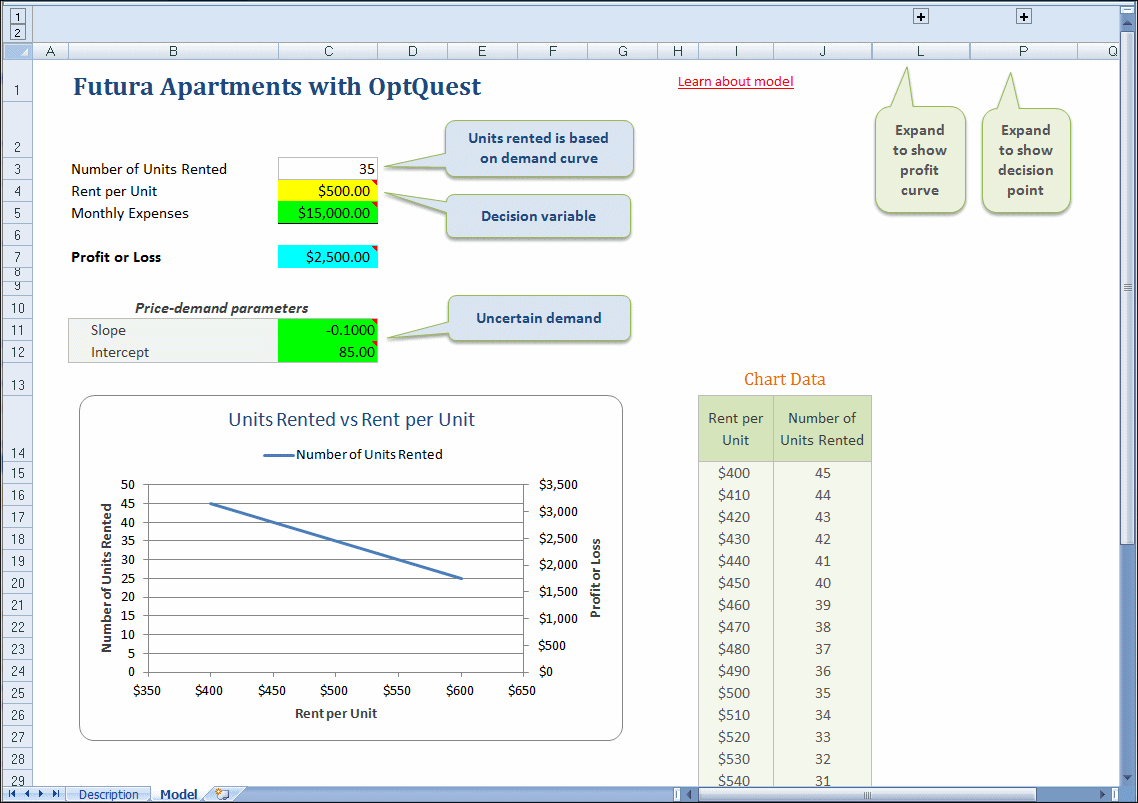

  2. Open the Futura With OptQuest.xlsx workbook from the Crystal Ball Example Models list (Figure 16, Futura Apartments Workbook).
    Figure 16. Futura Apartments Workbook
    Futura Apartments workbook.
    Notice that the rent is set to $500, where:
    Number of units rented = -.1(500) + 85 = 35
    and the total profit will be $2,500. If all the data were certain, the optimal value for the rent could be found using a simple data table. However, in a more realistic situation, monthly operating costs and the price-demand function parameters (-.1 and 85) are not certain (probability distributions for these assumptions are already defined for this example). Therefore, determining the best rental price is not a straightforward exercise.
