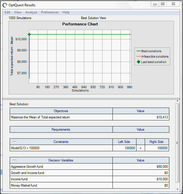

  1. For this tutorial, set the maximum number of simulations to 1000.
  2. Click Run.
    The OptQuest Results window opens (Figure 30, OptQuest Results Window — Best Solution View, Portfolio Allocation Model). It is displayed in Best Solution view, which provides an overview of the best solution found during the optimization.
    Figure 30. OptQuest Results Window — Best Solution View, Portfolio Allocation Model
    OptQuest Results window — Best Solution view, Portfolio Allocation model with results described in the following paragraph.
The mean of the Total Expected Return forecast, $10,413, is displayed in the Objectives table. In the Decision Variables table, you can see the amount to allocate to each fund to achieve the objective: Aggressive Growth fund = $90,000; Growth and Income fund = $0; Income fund = $10,000; and Money Market fund = $0.

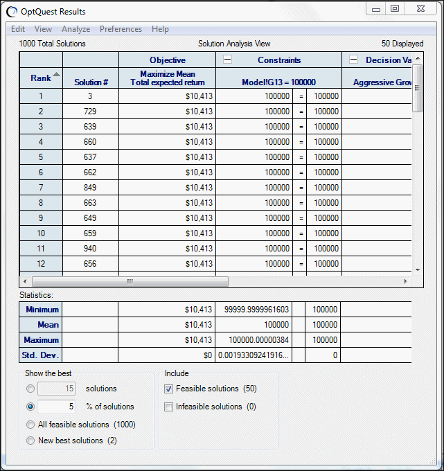

If you select View, and then Solution Analysis in the menu bar, the Solution Analysis tables are displayed.
Figure 31. OptQuest Results Window — Solution Analysis View, Portfolio Allocation Model
OptQuest Results window — Solution Analysis view, Portfolio Allocation model.
By default, the solutions list displays the best 5% of solutions ranked by the objective value. If you scroll the list, you can see the sets of decision variable values that OptQuest tried during its search for the best solution. You can also see the values of requirements and constraint formulas that were calculated based on these decision variables.
The statistics table below the solutions list shows the minimum, mean, maximum, and standard deviation values for the objective, the constraint, and each decision variable (the columns in the table).
