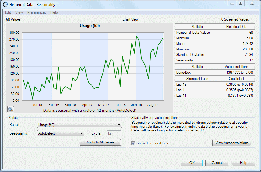

To view historical data values by series, in Data Attributes, click View Seasonality. The Historical Data - Seasonality dialog opens (Figure 2, Historical Data – Seasonality Dialog).
Historical Data - Seasonality contains:
Series chart, upper-left corner—By default, plots historical data values for the selected series; can also display autocorrelation coefficients (see Identifying Seasonality with Autocorrelations for details). In both views, seasonality is indicated by a repeating pattern.
Series group, lower-left corner—Lists all the data series in the selected spreadsheet cell range. The currently selected series is displayed in the chart. Contains:
Series—The selected series
Seasonality—Seasonality setting for the current series
Cycle—Number of time periods in each season or cycle for the current series
Apply to All Series—Applies the current settings to all series
Statistics, upper-right corner—Lists:
Statistics for seasonal data: number of data values, minimum value, mean value, maximum value, standard deviation of values, and the number of time periods in a cycle, such as 12 months in a year
Ljung-Box statistic for evaluating autocorrelations and the probability that data is not seasonal
The three most significant autocorrelation coefficients (up to a lag of one-half of the number of data points)

To show or remove trend corrections from the chart and statistics tables, select or clear Show detrended lags.
To confirm seasonality using autocorrelations between data at different time lags, click View Autocorrelations. The seasonality chart changes to Autocorrelations view (Identifying Seasonality with Autocorrelations).
