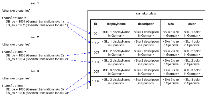

Every base item (in other words, every SKU, every product, every category, and so on) is tied, through its translations property, to one or more <baseType>Translation items. For each base item, a separate <baseType>Translation item exists for each locale (with the exception of the default locale, which we will get to momentarily). The following illustration shows three sku items and six corresponding skuTranslation items which contain translated content for two locales, Spanish and German:

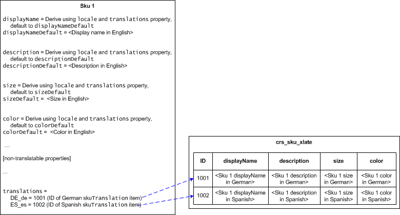

The following illustration is a graphic representation of the repository changes made by the International module. It shows a sku base item with two supporting skuTranslation items, one for German and the other for Spanish. The sku base item has been modified to add four <translatableProperty>Default properties: displayNameDefault, descriptionDefault, sizeDefault, and colorDefault. The sku base item has also been modified to add the translations property, which contains the map connecting the base sku item to its German and Spanish translation items. Finally, the displayName, description, size, and color property definitions have been changed to derived properties.

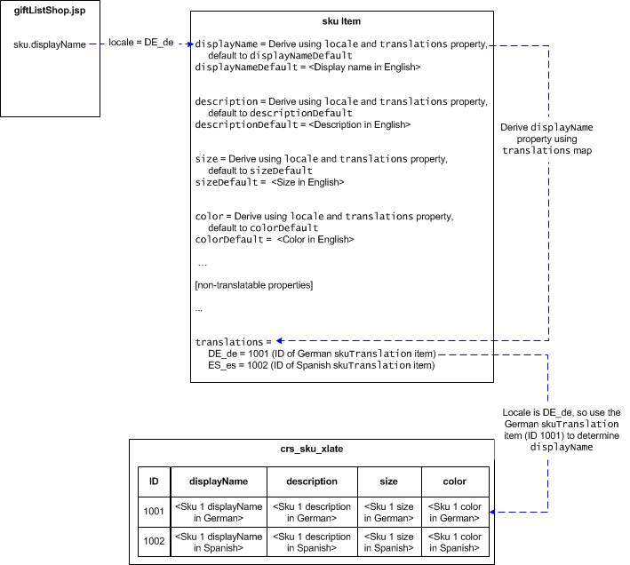

The following illustration shows how the sku.displayName property is derived for a store that has English (default), German, and Spanish translations:
In this illustration, the following happens:
giftListShop.jsprequests thesku.displayNameproperty for a SKU. The locale for the request is determined according to the rules described in Determining a Customer’s Locale and, in this example, isDE_de.The catalog repository finds the corresponding
skuTranslationitem using thesku.translationsproperty map. The repository determines that, for aDE_delocale, the GermanskuTranslationitem should be referenced.The catalog repository returns the
displayNameproperty from the GermanskuTranslationitem.

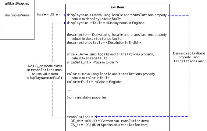

This next illustration shows what happens when a locale is specified that doesn’t exist in the sku.translations property map.
giftListShop.jsprequests thesku.displayNameproperty for a SKU. The locale for the request is determined according to the rules described in Determining a Customer’s Locale and, in this example, isUS_en.The catalog repository derives the display name for the SKU using the
sku.translationsproperty map. The repository determines that noskuTranslationitem exists for theUS_enlocale, so it returns the value from thesku.displayNameDefaultproperty, which for Commerce Reference Store is the English translation.
