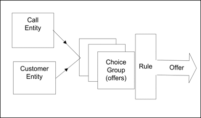

We will create a choice group of offers that can be extended to customers calling the service center. Choice scores are based on cost in order to support our Performance Metric of minimizing cost. Next, an Advisor is created to pass that cross sell recommendation to the CRM application, so that the call center agent can extend the offer.

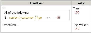

In the Inline Service Explorer, right-click the folder Scoring Rules and select New Scoring Rule. Name the scoring rule Credit Card Score. The editor for this new rule opens.
Click the Add conditional value icon to set up a rule condition in addition to the default:
A new row will appear, where the left cell is a two-sided rule and the right cell is the score value. The logic is as follows: "If the left cell evaluates to true, then the value in the right cell will be returned, otherwise use the value in the second row of the rule."
Click the left side of the rule and then on the ellipsis. An Edit Value dialog appears. Select Attribute, expand session attributes > customer and select Age, then click OK. Click the condition operator icon, then click the lower-right corner triangle:
Select the less than or equal to symbol (<=). Click in the right half of the rule and type the number 40. In the Then cell, type the number 130. In the second row, select and type in the number 147 for the value. The full rule should look like the one shown in Figure 4-2.
Save the Credit Card Score scoring rule. For the other offers, we will set constant values for the Cost score.

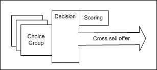

When an external system needs a decision to be made on its behalf, it calls an Advisor. Here, we create the Advisor that will send back to the CRM application an offer selected for a specific customer.
The Advisor's internal structure includes a Decision which associates it with one or more Choice Groups. These Choice Groups contain the offers that are to be made. The result of the decision is the result sent to the Advisor.
An Advisor has two decisions, one for normal processing and the other for the control group. The control group serves as a baseline to show performance gains achieved by Oracle RTD.
Figure 4-3 Structure of Get Cross Sell Offer Advisor

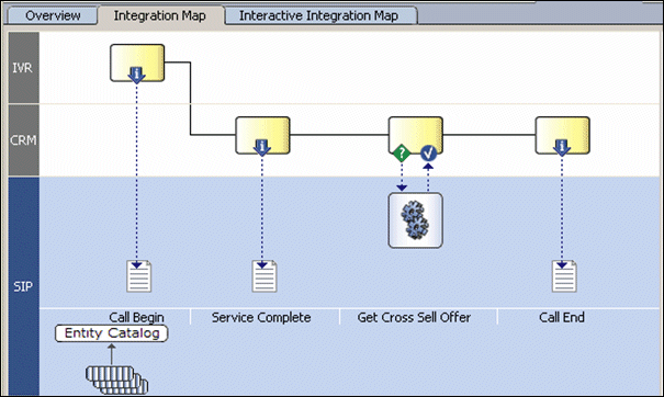

To view the Integration Map in Decision Center:
Open Decision Center by opening a Web browser and going to the URL http://server_name:8080/ui. Log in using the default administrator credentials you created during installation. Real-Time Decision Server must be started for Decision Center to run.
Click Open an Inline Service.
Select the Tutorial Inline Service.
On the left-hand tree, click the root node Tutorial. In the right pane, on the Definition tab, click to view the Integration Map subtab. You should see something similar to the map shown in Figure 4-5.
