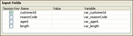

Select the Edit Script tab, then right-click the left area and select Add Action. We will add three actions, each corresponding to an integration point. We need the actions to be in the right order - CallBegin, ServiceComplete, and finally CallEnd.
For the first action, set the type to Message and the Integration Point name to CallBegin. In Input Fields, right-click and choose Add item to add an input field. Double-click in the space under Name and enter the value customerId; press Enter to register the new value. In the Variable column for customerId, choose var_customerId from the drop-down list. Select Session Key to identify this field as the session key.
For the action ServiceComplete, add three additional fields, as shown in Table 3-3.
Table 3-3 Additional Input Fields for ServiceComplete
| Name | Variable |
reasonCode |
var_reasonCode |
agent |
var_agent |
length |
var_length |
Again, the names here must match exactly with the incoming parameter IDs for the ServiceComplete Informant as seen in Decision Studio. Use the Toggle icon on the Inline Service Explorer task bar in Decision Studio to toggle between the label of the object and its object ID:
Figure 3-1 shows what the completed Input Fields section for ServiceComplete should look like.
Figure 3-1 Input Fields for ServiceComplete
In the Edit Script tab, right-click the left area and select Add Action. Set the type to Message and the Integration Point name to CallEnd. In Input Fields, right-click and chose Add item to add an input field. Set the Name to customerId, the Variable to var_customerId, and select Session Key.
Once again, save the Load Generator configuration script. Our Load Generator script now contains calls to three integration points. Make sure the order of the actions in the Edit Script tab is correct: CallBegin, ServiceComplete, and CallEnd. If not in this order, right-click the actions to move items up or down. Then, save the script again.
