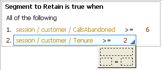

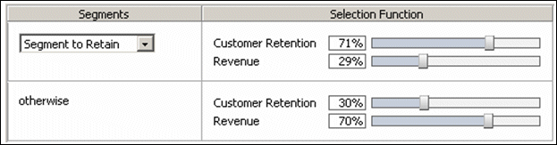

4.3 Adjusting the Priorities of Business Goals by Population Segment
One of the changes you can make to an Inline Service is to adjust the priorities of your business goals. The outcome of a decision is made based on the performance goals that are defined for your organization, the population segments that have been defined, and the prioritization of those goals for each segment of the population. Priorities can be adjusted on the Decision > Definition > Priorities subtab.
Figure 4-2 shows an example of priorities for business goals.
Figure 4-2 Priorities for Business Goals
Description of Figure 4-2 follows
Description of "Figure 4-2 Priorities for Business Goals"
In the example shown in Figure 4-2, the population segment called Segment to Retain has the Customer Retention business goal heavily weighted in its favor (71%), while the remaining population has maximizing revenue as a priority (29%).
If there is a special circumstance or a change in population, you can adjust this prioritization by sliding the weighting bar. Once adjusted, you must redeploy your Inline Service and log in to Decision Center again to see your changes.

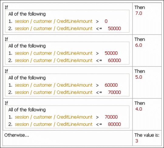

4.4 About Scoring Rules
As opposed to eligibility rules that return Boolean values, scoring rules return numeric values. These values can be used throughout the Oracle RTD Decision logic. Typical use cases are:
  • Setting the score of a choice for a given performance goal
  • Setting the value for a choice attribute
Figure 4-3 shows an example of a scoring rule.
In the example shown in Figure 4-3, scores are assigned based on a customer's credit line amount. If a customer does not fit any of the credit line range categories, the score defaults to 3.

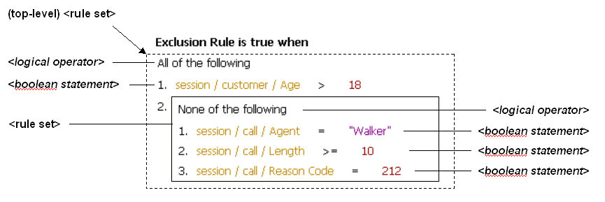

The following Exclusion Rule example shows a rule set within a rule set.
Surrounding text describes rule_sets1.gif.
In the example:
  • The top-level unnamed rule set contains the logical operator All of the following and two rule entries. The first rule entry is a boolean statement, the second rule entry is a rule set.
  • The rule set inside the top-level rule set contains the logical operator None of the following and three rule entries, each of which is a boolean statement.

4.5.4 Selecting an Operator
Click the operator, then click the lower-right corner to select an operator:
An operator and a triangle in the lower right corner.
