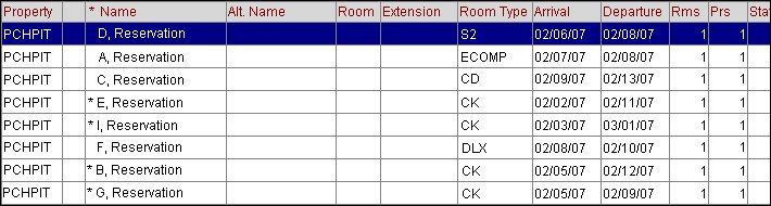

The search results grid lists the reservations that meet the search criteria you specified. Highlight the reservation and select the appropriate button to perform the actions enabled by the available function buttons. Lamps in the lower part of the screen alert you when the reservation has preferences, deposit/cancellation requirements, shares, profile notes, reservation comments, routing, QMS tasks, or other features associated with it (See Indicator Lamps for details).
The following information is displayed in the search results grid. All information is not applicable to every reservation.
Property. Property for which the reservation was made. This field is displayed if the OPP MHOT Multi-property license is active.
Color. Depending on the setting for the Reservations > Reservation Color Codes application setting, displays the user defined color associated with the Reservation, Market Code, or VIP Level as a quick reference to the user. (See Reservation Color Codes, Market Codes, or VIP Levels for details).
Name. Guest's last name and first name. A * (asterisks) is displayed by the name of the guest if the reservation is being shared with another guest. Hovering the mouse on the *, in the Name column title, displays a bubble message that shows that clicking the * will Sort by Shares. This option groups all of the guests sharing the reservation together in the search results grid by their assigned Share ID.
And the words Shared With, Persons Name will appear in blue on the bottom of the screen.
Alt Name. If the General > Extended Byte application parameter is set to Y, multiple-byte character sets may be used to enter names in languages that require extended-byte (for example, Chinese). If the profile includes a double-byte name, it appears in this field.
Room. The room number assigned to this reservation.
Extension. When the General > Extensions application function is set to Y, the extension number assigned to the reservation is displayed. Multiple extensions may be available in the specific room assigned to the guest and, if so, more than one extension may be assigned to the reservation. Select the Extensions lamp to open the Extension Numbers screen where all extensions assigned to the reservation are listed.
Room Type. The room type for this reservation.
Arrival. The guest's arrival date.
Departure. The guest's departure date.
Rooms. The number of rooms for this reservation. This column will not be displayed when the Reservations > Room Limit Per Reservation application setting is set to 1 and the Reservation > Shares application function is set to N.
Prs. Number of adults/children on the reservation.
Status. Reservation status.
Group/Company. The group and/or company associated with this reservation.
Note: If the Group profile is updated after one has already been associated to the Block/Reservation, this column will not be updated to the latest profile but will remain as the original associated profile.
Travel Agent/Source. The travel agent and/or source associated with this reservation.
Party. When the Reservation > Party application function is set to Y, the party that the reservation belongs to.
Rate Code. The rate code for this reservation.
Rate Amount. The rate amount for this reservation. Should the Reservations > View Suppressed Rate Details user permission not be granted, SR is displayed instead of the actual rate. See Suppressed Rates for details.
Note: If the Rates > Multi Currency application parameter is set to Y and rate codes are configured in various currencies, the rate amount displayed is based on the currency of the rate code.
Payment. The payment type attached to the reservation.
