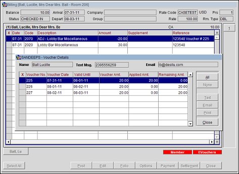

Handling Voucher Consumption on Transaction Code(s) and Associated Amount and Max Limit
The transactions posted to OPERA, either manually or via the interface, must have a check number assigned for them to be applied against the electronic voucher.
OPERA will use the Adjustment Codes associated with a transaction code to post discounts based on the voucher amount. In the event a check is posted for multiple transaction codes and a voucher is associated with multiple transaction codes, depending on the sequence associated with these transaction codes in the Electronic Voucher configuration, OPERA will post a discount/adjustment on the associated adjustment transaction code. The appropriate adjustment transaction codes and generates must be configured in order to post voucher discounts.
If the adjustment amount postings only need to be in one line item on the guest’s check, even though different adjustment codes occur, use Rollout functionality (CASHIERING > ROLLUP TRANSACTIONS application parameter), then it will show as one charge rolled up consisting of several transactions. For example, a check is posted to a guest room consisting of two different transaction codes. The total bill has a value of $150 with a transaction code 2000 (Food) $125 and transaction code 2090 (Beer) $25. $125 will be discounted to transaction code 2000 and $25 to transaction code 2090. On the guest’s bill there will be one posting for the original check and the voucher postings with a ‘+’ sign:
OPERA will note the original check number and another indicator in the check number field of the adjustment postings in order to group these.
The transaction code with the lowest sequence will be discounted first using the voucher amount from the oldest voucher (in case multiple vouchers exist). If any remaining voucher amount exists, it will be applied to the transaction code next in sequence.
If a transaction code does not have the adjustment code associated with it, OPERA will use the original/same transaction code to post an adjustment.
The adjustment posting will have the Voucher Number included in the reference field.
Based on the Max/Check value associated with the Electronic Voucher configuration record, OPERA will apply one or more vouchers to a single check/posting.
The adjustment postings will be automatic based on the main transactions postings either from POS or manually by a user. For interface postings, the relevant adjustment transactions will be posted to the folio after the entire check/set of transactions has been successfully completed posting from interface. For manual postings, the relevant adjustment transactions will be posted to the folio after the entire check/set of transactions has been successfully completed posting manually by the user and the transaction postings screen is closed.
Vouchers will be used if a transaction is posted either directly to a reservation or routed/transferred from another reservation.

OPERA updates the Applied Amount and the Remaining Amount on the Vouchers Details screen associated with the reservation automatically. If an adjustment posted due to a voucher that is moved/transferred to another reservation, the Applied Amount will not be changed. If a transaction code for which a voucher is applicable has been routed to another reservation, the Voucher may remain unused as the charge will never get posted in the guest ledger of the reservation where the voucher actually exists. Vouchers are non-transferable and must be used on the reservation where they are attached.
Note: The Electronic Voucher details screen will not allow selecting an expired voucher record and also the Text / Email and Print buttons will be disabled.

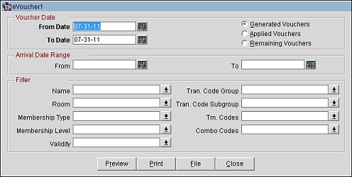

Statistics and reports can be generated based on consumed amounts and unconsumed amounts. Select the report Electronic Vouchers Details. The eVoucher1 screen displays:
eVoucher1
Voucher From Date. Manually enter, or select the Calendar button, the voucher beginning date of the date range for the report. Voucher To Date. Manually enter, or select the Calendar button, the voucher end date for the date range. These values refer to the Voucher date and Valid Until values on the Electronic Voucher Details screen accessed from Reservation Options > Electronic Vouchers.
Generated Vouchers. Select this radio button to create a report that displays all the electronic vouchers generated for the selected dates.
Applied Vouchers. Select this radio button to create a report that displays all the electronic vouchers that have been applied for the selected dates.
Remaining Vouchers. Select this radio button to create a report that displays all the electronic vouchers that are still valid / can be applied against, based on the validity of the voucher, and have remaining values for the selected dates.
Arrival From. Select the date to include vouchers only for the reservations that arrived on or after this date.
Arrival To. Select the date to include vouchers only for the reservations that arrived on or before this date.
Name. This field will display a list of guest names whose reservations arrived between the specified Arrival From and Arrival To dates.
The report will include the details as follows based on the radio button selected.
Name. Name of the guest attached to the reservation.
Room. The guest's room number.
Membership Type. Select the down arrow to display and choose from the Membership Type LOV.
Membership Level. Select the down arrow to display and choose from the Membership level LOV.
Validity. The Validity on the voucher configuration.
Tran. Code Group. Multi-select LOV for filtering on specific Transaction Code Groups. Only include those transaction codes that are part of the specific Code Group.
Tran. Code Subgroup. Multi-select LOV for filtering on specific Transaction Code Subgroups. Only include those transaction codes that are part of the specific Code Subgroup.
Trn. Codes. Multi-select LOV for filtering on specific Transaction codes.
Combo Codes. Multi-select LOV for filtering on specific Combo codes.
Function Buttons
Preview. Use the preview option to view the generated output of this report in PDF format.
Print. Use the Print button to print the report to the selected output.
File. Prints the generated report output to an *.rtf file.
Close. Closes this report screen.
