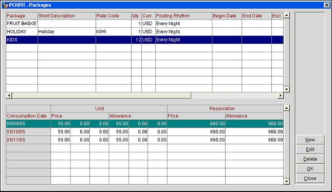

The Packages screen allows you to access a list of all packages that are attached to the reservation and cover the dates of the reservation. Any packages associated with the reservation because of the rate code you selected are automatically listed in the grid. The list also includes other packages that may have been added on to the reservation "manually."
Note: See Package Codes and Package Groups for details on configuring packages. Packages are configured by selecting Configuration > Rate Management > Packages.

The Package Consumption/Pricing Grid displays a breakdown of the highlighted Package in the Package Attached grid. This breakdown includes the date(s) that the packages are being consumed, the Prices, and Allowance amounts given for the package dates.

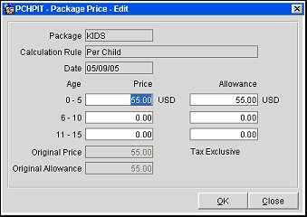

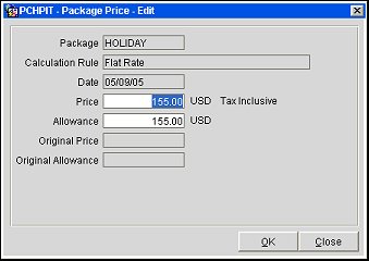

Note: When highlighting a consumption date and if the user has been granted the Reservations > Package Price Allowance Change permission, selecting the Edit button gives the user the option to update the Price and Allowance amount for that specific date. Any changes that are made will be attached and stored at the reservation level.
When editing a Price or Allowance, the user will be able to see the following fields for reference when updating:
Package
Calculation Rule
Date
Price - Tax Inclusive or Tax Exclusive
Allowance
Original Price
Original Allowance

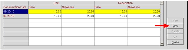

After an edit has been made to the Price or Allowance, then this item will have a Yellow background in the Package Consumption/Pricing Grid.![]()
But in a scenario where a consumption date that has had a price or allowance change but the allowance has not been posted or consumed, the user can select the Edit button to view the original price and original allowance. However, when price and allowance for a consumption date cannot be edited, the user can select View button to view the original price and original allowance.

Consumption Date. Specific date the package is being posted to the guest folio. In the event the package is a post next day, the allowance created will be for the next day, the consumption date is however still the date that the package is being posted to the guest folio.
Unit Price. The configured price for the package element at the time it was attached to the reservation. The price for the consumption date of the reservation can be updated for the reservation by selecting the Edit button. This amount is always displayed in the Currency associated with the Package Header.
Unit Allowance. The configured allowance amount that the guest can consume for the package element at the time the package was attached to the reservation. This allowance amount for the consumption date of the reservation can be updated by selecting the Edit button, but this amount cannot be less than the Price. This amount is always displayed in the Currency associated with the Package Header.
Note: When updating a reservation, for example changing any one or more of the key factors values such as Room Type, Number of Adults, Number of Children, Arrival/Departure Date, Nights, Discount, Fixed Rate, Rate Code, Block Code or manually refreshing the rates that will have an effect on the rate and subsequently the package that is included as part of a rate code; OPERA will automatically update the Unit Price and Unit Allowance displayed in the Package Consumption/Pricing Grid from the current business date onwards based on the existing Package Configuration. This will also update the Price displayed in the Reservation Price column and a prompt will appear stating “Reservation has been changed, Please verify the attached Packages." Package information, including the price and allowance on existing/ future reservations, will not be updated automatically based on package configuration changes unless a rate refresh is triggered on the reservation. The package information associated with the reservation including the price and allowance will continue to remain as it was at the time of creation of the reservation.
Example: Reservation arriving 01/01/11 for 1 night with Breakfast Package having a price of $10 and allowance of $15 for 01/01/11. The Package Consumption/Pricing Grid will display Unit Price of $10 and Unit Allowance of $15. Before the arrival of this guest, the package configuration for this date (i.e., 01/01/11) has been modified to set the price as $15 and the allowance of $20. This change will not affect the existing reservation (i.e., the Unit Price and Unit Allowance on this reservation for the Breakfast package will still remain $10 and $15 respectively). However if for example, the number of adults (one of the key factors) on the reservation are modified or user manually refreshes the rate, the new price and allowance for 01/01/11 will be populated, the Unit Price of $15 and Unit Allowance of $20 essentially overriding the existing price and allowance.
Reservation Price. The price of the package element for the reservation after the calculation rule has been applied to the Unit Price column. If the Unit Price is updated, then the price for this column will also be updated based on any calculation rule that may apply. This amount is always displayed in the Currency associated with the Rate Code.
Reservation Allowance. The allowance amount for the package element for the reservation after the calculation rule has been applied to the Unit Allowance column. If the Unit Allowance is updated, then the allowance for this column will also be updated based on any calculation rule that may apply. This amount is always displayed in the Currency associated with the Rate Code.

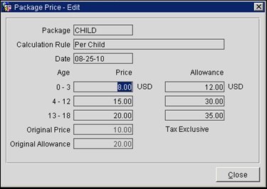

In the event the package attached to the reservation is configured as Per Child, the Package Consumption/Pricing Grid displays package price and allowance per child bucket as below, each of the 3 columns under Unit Price and Unit Allowance section are based on the MAX AGE RATE BUCKET1, MAX AGE RATE BUCKET2, MAX AGE RATE BUCKET3 application settings in the Rates group.
Note: Based on the introduction of the Package Price and Allowance storage on the reservation level, for various cashiering posting routines, when posting packages along with room and tax, the Price and Allowance on the reservation level will be referred to. All the calculation related to the Overage/Package Profit and Loss are now based on the Price and Allowance on the reservation level.

New. Select to add a new package. See Adding and Editing Add-on Packages, below. The packages visible in the LOV are those packages which have a package start and end date that make the package available within the dates of the reservation.
Edit. Select to edit the highlighted Package or Consumption Date. The Edit button remains active when items associated to the package were manually added and have a begin and end date that falls outside of the reservation dates. Consumption details for a date that has Advance Bill generated or that has an allowance created may not be edited.
Note: The user must be granted the Reservations > Reservation Package Edit permission to update any package details and must be granted the Reservations > Package Price Allowance Change permission to update any pricing or allowance details for the package.
Delete. Select to delete the highlighted package. The Delete button remains active even when items associated to the package were manually added and have a begin and end date that falls outside of the reservation dates. Packages that are included with the rate code or are inclusive cannot be deleted.
In the event a package is part of a package group, deleting it will display a message prompt stating “Package is attached to a package group, deleting this package will delete entire package group. Do you wish to continue?” with Yes and No options. Selecting Yes will delete the entire package group from the reservation.
Note: Ticket Packages that are attached to a reservation cannot be deleted if the ticket/tickets have been issued.
OK. Select to save and close out of the Packages screen. This button will be enabled only upon adding a new package or editing an existing package.
Close. Closes out of the Packages screen.
