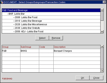

Transaction Code(s). The transaction codes you have selected to include (or exclude, if Inclusive is unchecked) from the transfer. Select the down arrow on the left side of the field or press the [F9] key to display the Select Groups screen.
The Select Groups screen consists of two grids. The top grid displays a list of the transaction codes and routing codes for your property. From this list, you may select the individual transaction codes and/or routing codes that will be transferred. The codes you have selected appear in the lower grid.
For example, in the top grid, highlight a routing code (e.g., F&B, which might include all restaurant and bar charges), and/or a specific transaction code (e.g., transaction code 5000 - Greens Fees). Then select the Select button to move the highlighted transactions to the lower grid, which shows the transactions that you have chosen.
To remove a selected entry from the lower grid, highlight the entry and select the Remove button.
When you select a routing code, all transaction codes within that routing code are chosen, when you select an individual transaction code, only that specific transaction code is chosen. When you have made your choices, select OK to return to the Transfer Grouped Postings screen. Select OK to immediately complete the transfer.

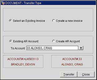

When selecting the Transfer button on the Invoice Details screen (AR>Account Maintenance>Invoice button), then specific transactions can be transferred to another invoice. The following lists when transactions cannot be transferred to another invoice:
The Transfer Type screen allows for the ability to select an existing invoice or create a new invoice to transfer the transaction to. Once that is selected, then an existing AR Account will need to be selected or a new AR Account can be created.
When the steps are completed and both accounts are populated in red text, select the Transfer button to complete the transaction transfer.
