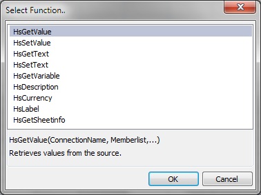

In Select Function, select a function from the list and click OK.
Note: | Not all functions are available to all providers. See Table 35, Smart View Functions and Supported Providers for a list of functions and the supported providers. |
