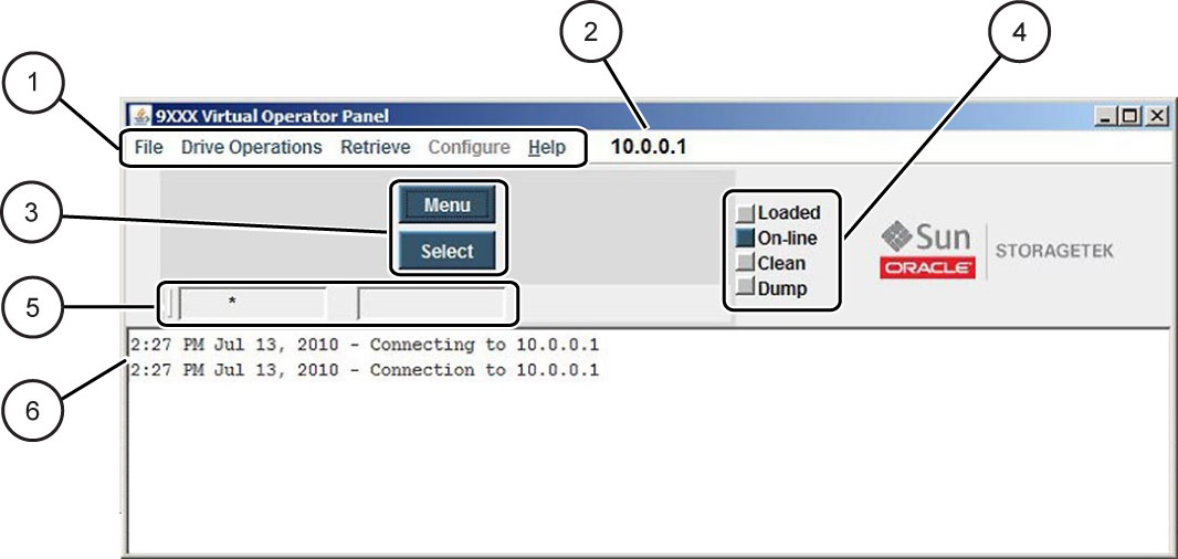

Figure 12-1 shows the 9XXX VOP main interface:
Figure 12-1 9XXX VOP Interface
Surrounding text describes Figure 12-1 .
Legend:
1. Menus
2. Drive IP
3. Menu and Select Switches
4. Primary and Secondary Message Windows
5. Status Indicators
6. Transcript Pane
As shown in Figure 12-1, the 9XXX VOP interface includes the following:
  • Menus
    Use menus to issue 9XXX VOP commands. See "Using 9XXX VOP Menus" for more information.
  • Drive IP
    Displays the IP address of the tape drive loaded.
  • Menu/Select Switches
    Use these switches to access the tape drive menu system. See "Using Menu and Select Switches" for more information.
  • Tape Drive Status Indicators
    These indicators show the current drive state:
    • The Empty/Loaded status indicator indicates whether a tape cartridge is loaded in the tape drive. When you load a cartridge in the tape drive, this status indicator changes from gray to blue, and indicates Loaded.
    • The Online/Offline status indicator indicates whether the Ethernet adapter card is online. When you bring a tape drive online, this status indicator changes from gray to blue, and indicates Online.
    • The Clean status indicator indicates that the tape drive must be cleaned.
    • The Dump status indicator indicates that a dump is present for retrieval.
  • Primary and Secondary Message Windows
    Display status messages during 9XXX VOP processing.
  • Transcript Pane
    Displays a transcript of 9XXX VOP actions and prompts for additional input or actions.

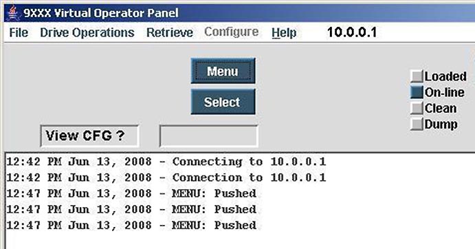

Menu Button
Click the Menu button to enter the drive menu system or advance to the next portion of the drive menu system. Menu options and values display in the primary message window.
Figure 12-2 shows an example:
Figure 12-2 9XXX VOP Menu Switch
Surrounding text describes Figure 12-2 .
As shown in Figure 12-2, the Menu button has been clicked several times and View CFG? appears in the primary message window.
Select Button
Click the Select button to advance to the next available menu option or value, to enter a submenu (such as View CFG?), or to exit from either a submenu or the main menu system.
Figure 12-3 shows an example:
Figure 12-3 9XXX VOP Select Switch
Surrounding text describes Figure 12-3 .
As shown in Figure 12-3, the Select button has been clicked, resulting in an exit from the main menu system. An asterisk (*) appears in the primary message window.
