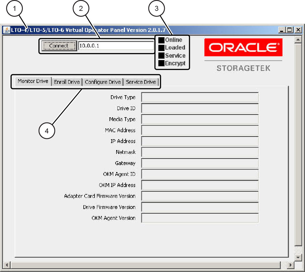

LTO VOP Interface
Figure 11-1 shows the LTO VOP main interface:
Figure 11-1 LTO VOP Interface
Surrounding text describes Figure 11-1 .
Legend:
1. Title Bar (Includes Menus)
2. Connect Button
3. Tape Drive Status Indicators
4. Function Tabs
As shown in Figure 11-1, the LTO VOP interface includes the following:
  • Title Bar
    Click the icon in the title bar to access a basic menu you can use to re-size the window and close the application.
  • Connect Button
    Enter the IP address of your LTO tape drive in the accompanying field and click the Connect button.
  • Tape Drive Status Indicators
    These indicators show the current drive state:
    • The Online/Offline status indicator indicates whether the Ethernet adapter card is online. When you bring a tape drive online, this status indicator changes from gray to blue, and indicates Online.
    • The Empty/Loaded status indicator indicates whether a tape cartridge is loaded in the tape drive. When you load a cartridge in the tape drive, this status indicator changes from gray to blue, and indicates Loaded.
    • The Service status indicator indicates whether the Ethernet card is communicating with the tape drive.
    • The Encryption status indicator indicates whether the tape drive is enrolled for encryption.
      You can click directly on certain status indicators to toggle the state of the monitored tape drive item.
  • Function Tabs
    These tabs provide functions used to configure, monitor, and service the tape drive. See "LTO VOP Function Tabs" for more information.

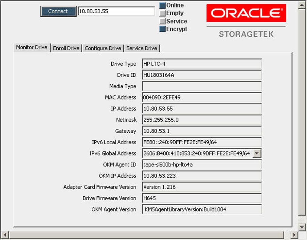

Monitor Drive
Click this tab to display a list of tape drive, cartridge, and OKM agent attributes and values for those attributes. Some attributes require an additional action, such as tape drive enrollment for encryption, before the associated data appears.
Figure 11-2 shows an example of the Monitor Drive page:
Figure 11-2 LTO VOP Monitor Drive tab
Surrounding text describes Figure 11-2 .
As shown in Figure 11-2, this page lists the following tape drive attributes:
  • Drive Type
  • Drive ID
  • Media Type
  • MAC Address
  • IP Address
  • Netmask
  • Gateway
  • IPv6 Local Address
  • OKM Agent ID
  • OKM IP Address
  • Adapter Card Firmware Version
  • Drive Firmware Version
  • OKM Agent Version

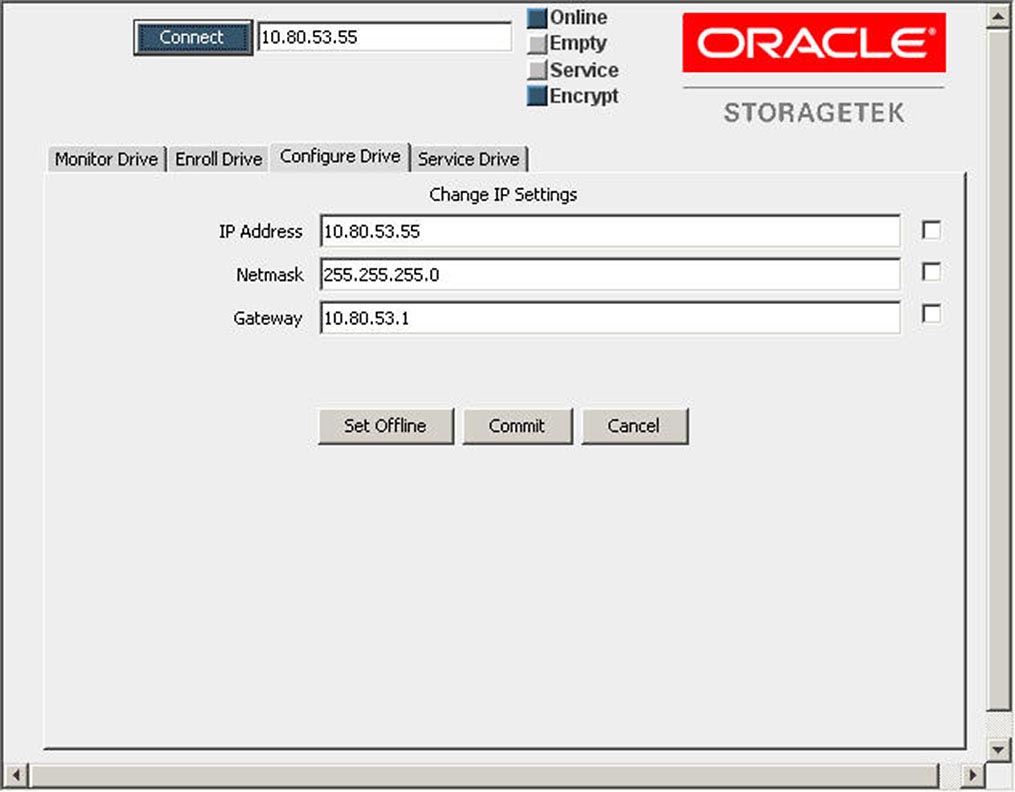

Configure Drive
Refer to your encryption documentation before using this page. The sequence for using the Configure Drive and Enroll Drive tabs is critical to success.
Click this tab to access functions used to specify IP settings for the tape drive. This page is typically used by the service representative to configure the tape drive to use settings other than those set during the manufacturing process.
Figure 11-4 shows an example of the Configure Drive page:
Figure 11-4 LTO VOP Configure Drive tab
Surrounding text describes Figure 11-4 .
As shown in Figure 11-4, this page includes fields to specify IP settings, and buttons to perform related operations.
To change a setting, enter a new value in a field. The accompanying Update check box is automatically selected to indicate a change.
Fields
The Configure Drive page includes the following fields:
IP Address
Enter the IP address for the tape drive.
Netmask
Enter the Netmask for the tape drive.
Gateway
Enter the Gateway for the tape drive.
Buttons
The Configure Drive page includes the following buttons:
Set Offline
Click this button to set the tape drive (adapter card) offline.
The label on this button changes depending on the current drive state (for example, the label is Set Offline when the drive state is Online).
Commit
Click this button to save the IP settings in NVRAM. The Ethernet card reboots when you change an IP setting. When you click the Commit button, only those fields with an active check box are updated.
Cancel
Click this button to unselect all pending setting changes.

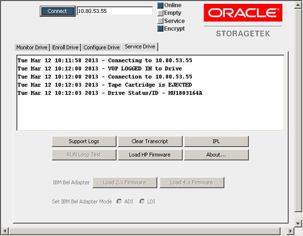

Service Drive
Click this tab to access functions used to perform service functions on the tape drive. These functions are primarily intended for the service representative.
Figure 11-5 shows an example of the Service Drive page:
Figure 11-5 LTO VOP Service Drive tab
Surrounding text describes Figure 11-5 .
As shown in Figure 11-5, this page contains a text-based transcript area and the following buttons:
Support Logs
Saves log files to a specified location.
Clear Transcript
Erases the content displayed in the text pane.
IPL
Performs an Initial Program Load (IPL) of the Ethernet card.
RUN Loop Test
Performs an internal loopback test on the tape drive.
Load HP Firmware
Starts the Ethernet card firmware update procedure. You are prompted to identify the directory that contains the Ethernet card firmware files.

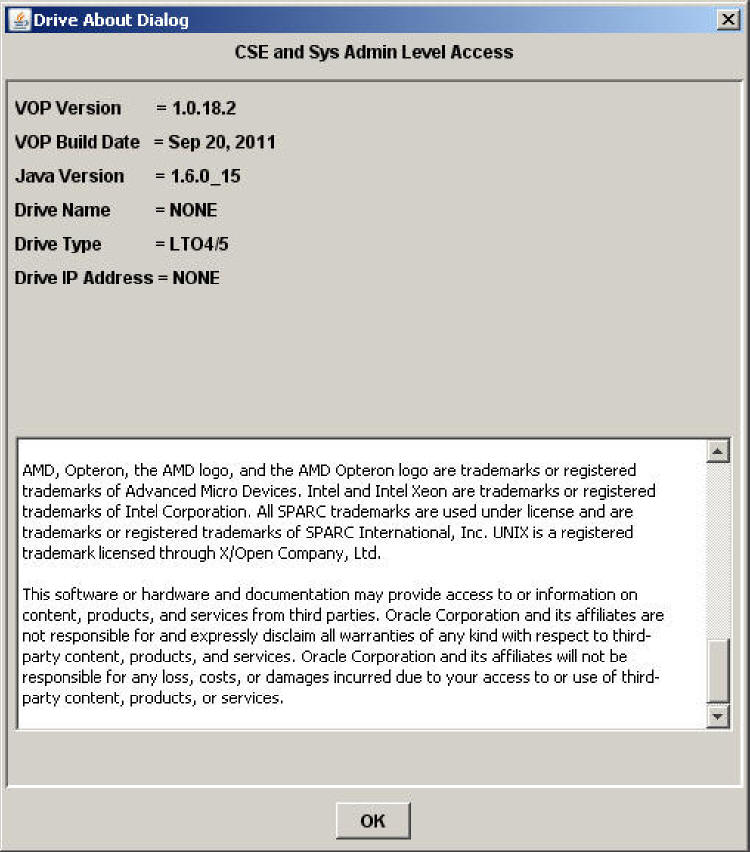

About
Displays LTO VOP version, basic tape drive information, and copyright information. For example:
Figure 11-6 LTO VOP About Dialog
Surrounding text describes Figure 11-6 .
