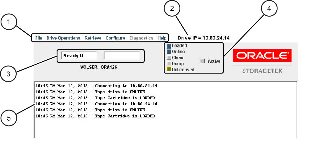

This chapter describes how to use the T10000 9840D Virtual Operator Panel (VOP) with a single T10000 or T9840D tape drive.
Designed for ease of use, the T10000 9840D VOP Graphical User Interface (GUI) enables you to do the following:
Monitor tape drive status
View or change tape drive configuration settings
Perform tape drive operation utilities
Figure 10-1 shows the T10000 9840D VOP main interface:
Legend:
1. Menus
2. Drive IP
3. Primary and Secondary Message Windows
4. Status Indicators
5. Transcript Pane
As shown in Figure 10-1, the T10000 9840D VOP interface includes the following:
Menus
Use menus to issue T10000 9840D VOP commands. See ”"Using T10000 9840D VOP Menus" for more information.
Drive IP
Displays the IP address of the tape drive loaded.
Display status messages during T10000 9840D VOP processing.
Tape Drive Status Indicators
These indicators show the current drive state:
The Empty/Loaded status indicator indicates whether a tape cartridge is loaded in the tape drive. When you load a cartridge in the tape drive, this status indicator changes from gray to blue, and indicates Loaded.
The Online/Offline status indicator indicates whether the Ethernet adapter card is online. When you bring a tape drive online, this status indicator changes from gray to blue, and indicates Online.
The Clean status indicator indicates that the tape drive must be cleaned.
The Dump status indicator indicates that a dump is present for retrieval.
The Enabled/Unlicensed status indicator indicates whether the tape drive is encrypted.
When a tape drive is encrypted and has all keys, the status indicator is orange, and indicates Enabled.
When a tape drive is missing an encryption key or has not been enrolled, the status indicator is red and indicates Unlicensed.
Note: You can click directly on certain status indicators to toggle the state of the monitored drive item. |
Transcript Pane
Displays a transcript of T10000 9840D VOP actions and prompts for additional input or actions.

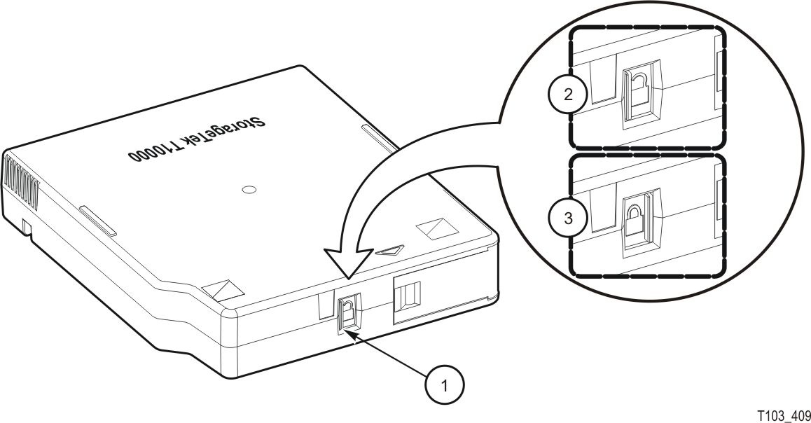

Insert a write-enabled cartridge.
Make sure the cartridge's write protect switch is in the write-enabled position as indicated by the open padlock icon shown in Figure 10-2.
Legend:
1. Write Protect Switch
2. Unlocked (Write Enabled) Position
3. Locked Position
