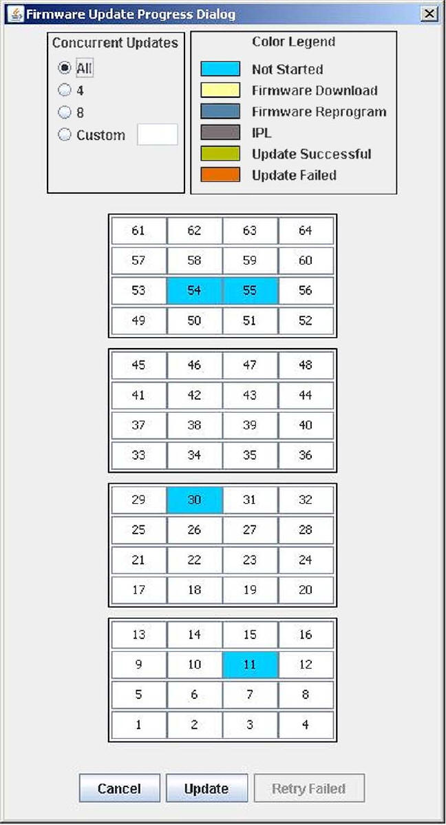

To load firmware, do the following:
Select one or more tape drives that are to receive new firmware. The tape drives you select must be of the same drive type.
Click the Drive Operations menu and select Set Selected Drives Offline.
Click the Configure menu and select Firmware Update from File in This Library. A Code Load from File screen appears.
Locate and click the firmware file, and click the Open button.
Click the Update button. The Firmware Update Progress dialog box appears, displaying the tape drives that are selected for a firmware update.
Click an option to select one of the following Concurrent Updates settings:
All
Update all selected tape drives simultaneously.
4/8
Update the selected tape drives in groups of four or eight, one group at a time.
Custom
Specify the number of tape drives to be updated simultaneously, before the next group is updated.
Click the Update button to begin transferring the firmware to the selected tape drives. The legend displays the results of each step of the process:
Not Started
The firmware update has not started.
Firmware Download
The firmware is transferring to the tape drive.
Firmware Reprogram (firmware update process has started)
The firmware process has started.
IPL
The tape drive has rebooted.
Update Successful
The Firmware update succeeded.
Update Failed
The firmware update failed.

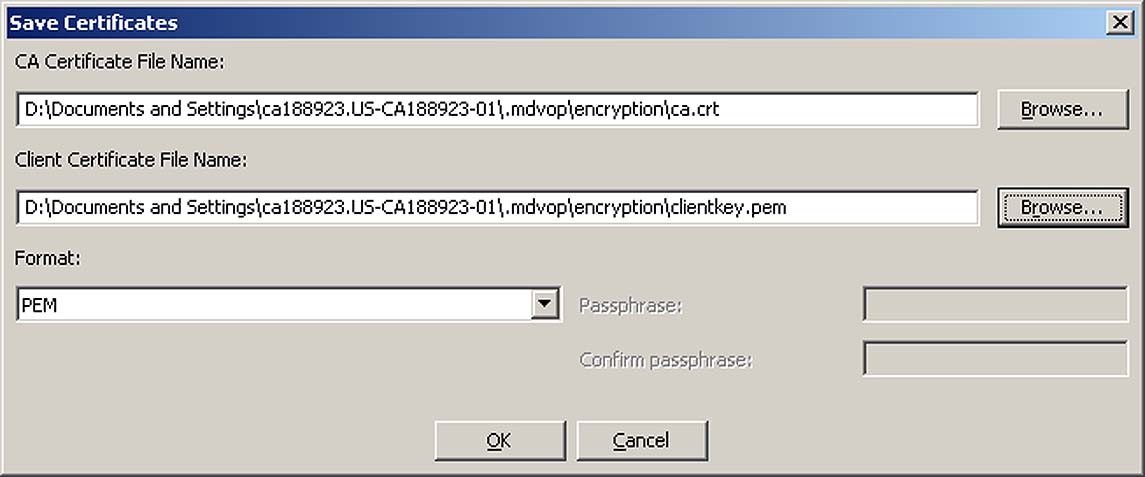

Before using the MD-VOP encryption commands, you must obtain the CA certificate and Client certificate files from OKM.
Launch the OKM GUI (version 2.3 or later).
Connect to OKM in the Operator role.
In the OKM GUI, click the System menu and select Save Certificates. The Save Certificates dialog box appears.
Enter the location on the MD-VOP host where certificates are to be stored. You must enter both the CA Certificate File Name and Client Certificate File Name.
Click the OK button to retrieve the certificate files from OKM.
