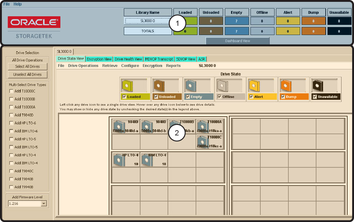

Figure 7-1 shows the MD-VOP main interface:
Legend:
1. Dashboard
2. Library Panel
As shown in Figure 7-1, The MD-VOP interface is divided into two sections:
The Dashboard displays the general state of all tape drives in your configuration.
The Library Panel displays information for tape drives in a selected library or VSM.
Both sections include menus you can use to perform various functions on selected tape drives.

The Library Panel displays information for tape drives in a selected library. It includes menus you can use to control, update, and view selected tape drives within the library.
Figure 7-3 shows the MD-VOP Library Panel:
Legend:
1. Library/VSM tabs
2. Drive View tabs
3. Menus
4. Legend
5. Drive Details
6. Drive Selection Panel
As shown in Figure 7-3, the Library Panel includes the following:

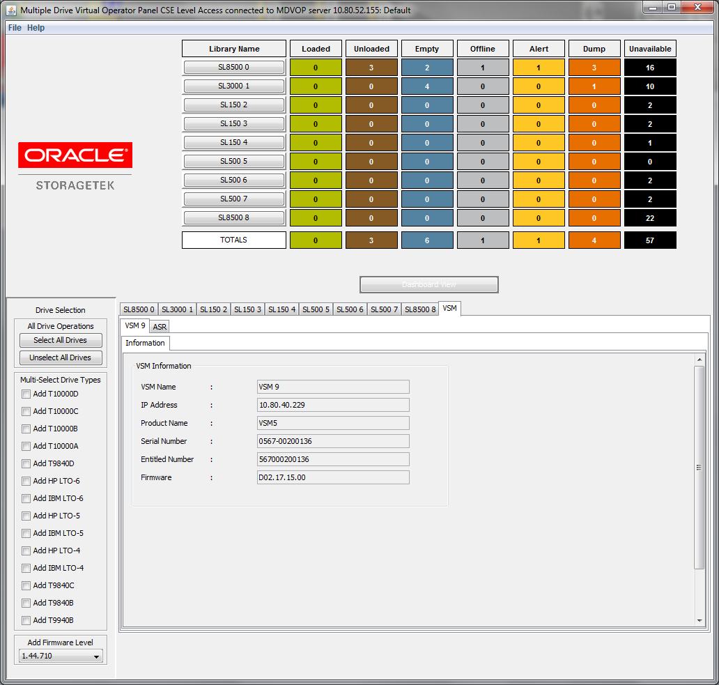

In server mode, if one or more VSMs are configured, a VSM tab appears in the Library Panel. When you click the VSM tab, the Library Panel displays VSM information for configured VSMs, as shown in Figure 7-4.
The following VSM information is displayed:
VSM Name
IP Address
Product Name
Serial Number
Entitled Number
Firmware

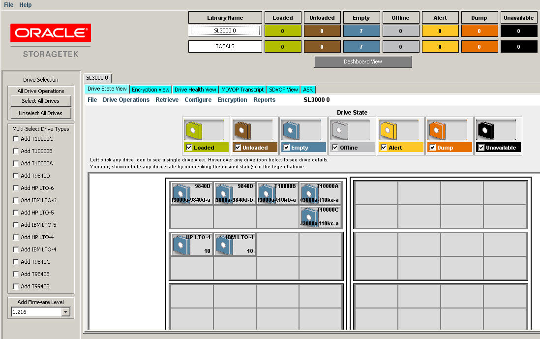

From the MD-VOP Library Panel, select the Drive State View tab to display the current state of the tape drives in the selected library. You may encounter a minimal delay when this view is selected.
This view is only supported for the T9840D, T10000 series, and LTO 4/5 tape drives. All other drives will display a white icon as an indicator of connection, for which other logs can be obtained.
Figure 7-5 shows an example of the Drive State view:

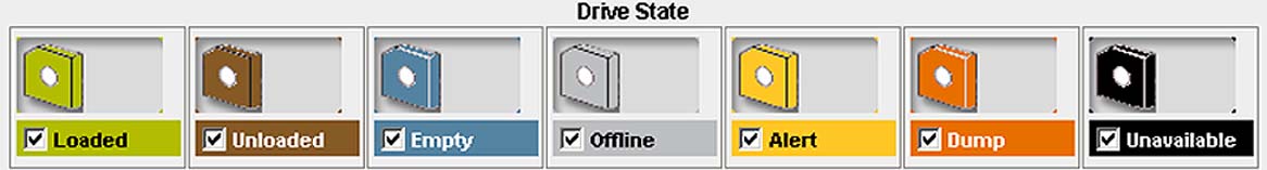

Figure 7-6 shows the legend displayed in the Drive State View:
You can use the legend to filter the tape drives that are displayed in the Library Panel. Click the check box for a particular drive state to include or exclude applicable drives in the Library Panel.
By default, the legend includes the following drive states:
Note: You can customize icon labels and colors. See "Changing MD-VOP Default Settings" for more information. Figure 7-6 shows the legend displayed after a first time installation. |
Loaded
A tape cartridge is loaded and is ready to be used by the tape drive. This status is green by default.
Unloaded
A tape cartridge is unloaded. The tape cartridge resides in the tape drive, but is not actually threaded through the tape drive. This status is brown by default.
Empty
There is no tape cartridge in the tape drive. This status is blue by default.
Offline
The tape drive has been set to not allow some activity to the backup system. This state is used for maintenance to the tape drive. In this state, commands from the host (backup server) are not processed. This status is gray by default.
Alert
The tape drive is in need of cleaning due to periodic or error detection limits. This status is yellow by default.
Dump
A dump can occur for a problem that falls outside of the limits in the firmware on the tape drive. This is an SNO (should not occur) in a memory dump from the tape drive. Send the dump to Support for analysis. This status is orange by default.
Unavailable
A tape drive is not communicating with MD-VOP. This status is black by default.

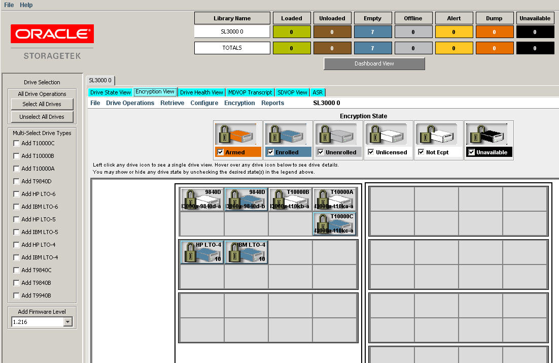

From the MD-VOP Library Panel, click the Encryption View tab to display the current encryption state of the tape drives in the selected library. You may encounter a minimal delay when this view is selected.
Note: By default, the Encryption view is not displayed, unless you indicated to include it when you installed MD-VOP. You can activate this view using the MD-VOP Default Settings screen. See "Changing MD-VOP Default Settings" for more information. |
Only T9840D, T10000 series, and encrypting LTO tape drives support encryption through an Oracle Key Manager (OKM) system.
Figure 7-7 shows an example of the Encryption view:

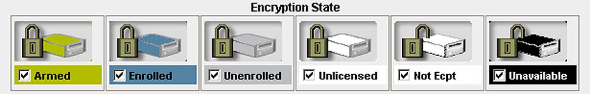

Figure 7-8 shows the legend displayed in the Encryption View:
You can use the legend to filter the tape drives that are displayed in the Library Panel. Click the check box for a particular drive state to include or exclude applicable tape drives in the Library Panel.
By default, the legend includes the following encryption states:
Note: You can customize icon labels and colors. See "Changing MD-VOP Default Settings" for more information. |
Armed
The tape drive has acquired an encryption key from OKM. The tape drive can write encrypted data. This status is green by default.
Enrolled
The tape drive is enrolled with OKM but does not have an encryption key from OKM. This status is blue by default.
Unenrolled
The tape drive has been reset and is no longer enrolled with OKM. The tape drive cannot write encrypted data. This status is gray by default.
Unlicensed
The tape drive is capable of encryption, but the license key for the tape drive has not been sent to the tape drive. This status is white by default.
Not ecpt
The tape drive is not capable of encryption. This status is white by default.
Unavailable
The tape drive is not communicating with MD-VOP. This status is black by default.

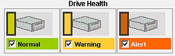

From the MD-VOP Library Panel, click the Drive Health View tab to display the current health status of the tape drives within the selected library. You may encounter a minimal delay when this view is selected.
Note: At MD-VOP startup, the ”good” state color is indicated by default. This remains until you issue a Perform Health Check command from the Library Panel Drive Operations menu. See "Drive Operations Menu" for more information. |
Figure 7-9 shows an example of the Drive Health view:
Figure 7-10 shows the legend displayed in the Drive Health view:
You can use the legend to filter the tape drives that are displayed in the Library Panel. click the check box for a particular drive state to include or exclude applicable tape drives in the Library Panel.
By default, the legend includes the following drive health states:
Normal
No events are found on the tape drive. This status is green by default.
Warning
The tape drive has a concern that requires review. This status is yellow by default.
Alert
The tape drive requires attention. This status is also triggered when the tape drive is unavailable for connection. This status is red by default.

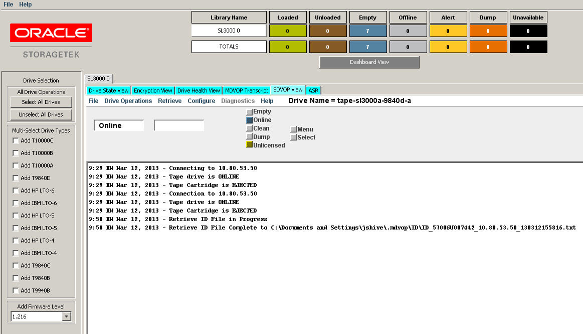

Click a tape drive icon in the Library Panel to access the SDVOP (single-drive) View for that tape drive. The SDVOP View tab becomes active.
If you click a T9840D or T10000 tape drive, the T10000 9840D SDVOP interface is displayed in the MD-VOP Library Panel. See Chapter 10, "Using T10000 9840D VOP" for information about using T10000 9840 VOP.
If you click an LTO tape drive, the LTO VOP interface is displayed in the MD-VOP Library Panel. See Chapter 11, "Using LTO VOP" for information about using LTO VOP.
If you click a T9840B, T9840C, T9940A, or T9940B tape drive, the 9XXX VOP interface is displayed in the MD-VOP Library Panel. See Chapter 12, "Using 9XXX VOP" for information about using 9XXX VOP.
Figure 7-12 shows an example of the SDVOP view for a T10000 tape drive:
As shown in Figure 7-12, the SDVOP View is active, and the T10000 9840D VOP interface is displayed in the MD-VOP Library Panel.

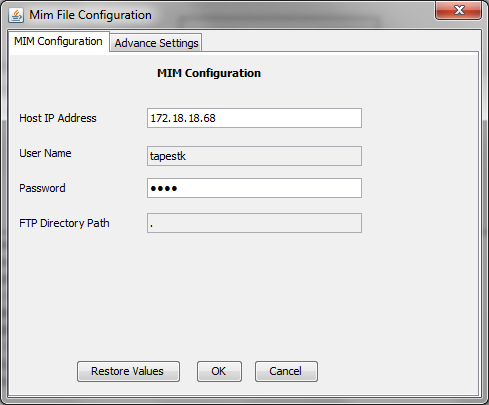

For a 9xxx tape drive, use the edit MIM to configure the device. You can configure a single device or multiple devices. If you are configuring a single device, go to the single drive view. See SDVIEW.
Place the tape drive offline.
Under Configuration, select MIM. The MIM File Configuration screen appears:
Enter the Host IP address for the server (use the port that the tape drives is attached to). Then click OK.
Note: Only use the Advanced Settings tab as directed by Oracle support. |
