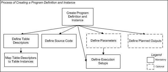

Figure 5-1 Process of Creating a Program Definition and Instance
Description of Figure 5-1 follows
Description of "Figure 5-1 Process of Creating a Program Definition and Instance"

To create an Oracle Life Sciences Data Hub (Oracle LSH) Program you write or upload source code in SAS, PL/SQL, or Oracle Reports as you normally would. In addition, you must create a defined object in Oracle LSH called a Program, and create defined objects for each of the following included in your source code:
  • You must define a Table Descriptor object for each source and target table or data set that your program reads from and writes to. You must then map each Table Descriptor to the actual Table instance the program reads from or writes to.
  • You must define a Source Code object for the primary source code you write and for any separate subroutines, macros, or formats you use.
  • You must define a Parameter object for each input, output, or input/output parameter you declare in your source code.
  • You must define a Planned Output object for each output the Program will produce, including reports, error files, and log files (except SAS log files, which the system creates automatically).
  • As with other Oracle LSH executables, you must define at least one Execution Setup to enable users to run the Program. See "Creating, Modifying, and Submitting Execution Setups" for further information.
