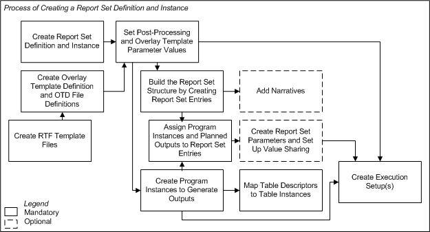

Figure 9-1 Process of Creating a Report Set Definition and Instance
A Report Set provides a way to organize, manage, and run a set of reports together under version control. You can define numbered chapters, sections within the chapters, and any number of levels of subsections, with reports and/or narrative text at any level. When you choose to use postprocessing, the Oracle Life Sciences Data Hub (Oracle LSH) generates a table of contents and hyperlinks to each report.
Each report in a Report Set is generated by the execution of a Program instance whose corresponding Planned Output is assigned to the particular chapter, section, or subsection (all of which are called Report Set Entries) where the report appears in the final output. A single Program instance can generate multiple reports, each of which can be assigned to a different Report Set Entry. Reports can take the form of tables, listings, figures, or text, depending on the technology you use to create them and how you define them.
You can include Program instances of different technology types—including SAS, Oracle Reports, and PL/SQL—in the same Report Set. When you execute the Report Set, the system sends each Program instance to the appropriate engine for execution and integrates the results.

Create the Report Set. Create the Report Set definition and an instance of it, then click Update to set the Strict and Unique numbering properties for the Report Set. See "Creating a Report Set" for further information.
Set Parameter values at the top Report Set level. Set values at the top Report Set level for predefined Overlay Template and Post-Processing Parameters. This ensures that all Report Set Entries have values for these Parameters in the Report Set instance and in the Execution Setup. "Creating and Setting Report Set Parameters".
Create Report Set Parameters (optional). To make the Report Set easier to submit and to help ensure data consistency, you may want to define one or more Parameters at the Report Set level. For example, if all the reports in a Report Set are about the same study, and the Programs that create the reports have an input Parameter to identify the study, you may want to define a Study Parameter at the Report Set level and share its value with each Program's Study Parameter. The Report Set Study Parameter appears at the top of the Report Set's Execution Setup where the user can easily find it and set it once for the whole Report Set. See "Setting Up Parameter Value Propagation" for further information.
Define the Report Set structure. A Report Set has top-level chapters that contain subchapters that can in turn contain any number of levels of sections and subsections. All of these are called Report Set Entries. You must define a Report Set's structure by defining hierarchical Report Set Entries from the top down; see "Using the Report Set Structure View".
Develop, test, and validate Report Set Entries and Programs. Develop the Programs that generate the Report Set's reports. Assign each Program Planned Output to the Report Set Entry (chapter, section, or subsection) where it should appear. Add pre- and post-report narratives as necessary to Report Set Entries. Adjust the settings for Post-Processing and Overlay Template Parameters as necessary. Test and validate Programs, Report Set Entries, and report outputs according to your company's standards. See "Defining Report Set Entries" and "Validating Report Set Definitions and Outputs" for further information.

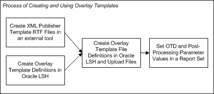

Oracle LSH's postprocessing feature uses Oracle XML Publisher to generate a single- or multi-volume PDF-format Report Set with a unified Table of Contents from the individual PDF reports and narratives generated by the first stage of Report Set execution.
To use the postprocessing feature, you must design and create RTF templates that can include graphics, watermarks, hyperlinks, text variables, and the font styles and sizes you prefer.
You create template files in Microsoft Word or a similar tool, save them as RTF files, and upload each one to an Overlay Template Definition (OTD) File definition in an OTD. In the OTD File definition you specify the file's orientation, paper size, language, and rotation.
For information on creating template files, see the Oracle XML Publisher User's Guide, which is available on My Oracle Support and the Oracle Technology Network.Templates Applied at Runtime For the Table of Contents and Narratives, Oracle LSH uses the runtime values of the Post-Processing Parameters Paper Size, Language, and Orientation to determine which template files associated with the OTD to apply. To determine which template files to use for the actual reports, or content, Oracle LSH uses Paper Size, Language, and the orientation of the actual PDF report output.
Therefore you can, for example, create a single OTD with template files for both A4 and US letter-sized paper, and use different values for the Paper Size Post-Processing Parameter to print it out on A4 paper in Europe or Japan and letter-sized paper in the US or Canada.
In Oracle LSH Release 2.2.2 the only language supported is US English.Overlay You can create multiple template files in the same Overlay Template definition with the same values for Paper Size, Orientation, and Language. In this case, Oracle XML Publisher uses all of them, overlaying them on top of each other on each page. For example, you can create one template file with a rotation of 90 degrees to print the Report Set title and your company logo vertically along the side margin, and another template file for the main body of the page with a rotation of 0. Because both files have the same orientation and paper size, the system applies both; see Figure 9-2, "Example with Banner Template File".
Oracle recommends creating a single OTD containing all the template files you may need to postprocess a single Report Set. Decide which options represented by Post-Processing Parameters you want to support—A4 and/or US Letter-sized paper, landscape and/or portrait orientation— and create the template files necessary to support them in a single OTD. The values for the Post-Processing Parameters can be set in the Report Set definition, in the Execution Setup definition, or by a user submitting the Report Set for execution. Oracle LSH selects the template(s) to use for each section of the Report Set based on these Parameter values at runtime.

You create Overlay Template definitions directly in an Application Area or Domain library, not a Work Area. They do not have instances.
To create an Overlay Template, do the following:
In a Domain or Application Area, click Manage Definitions.
From the Create drop-down list, select Overlay Template. The Create Overlay Template screen opens.
Enter a Name for the Overlay Template.
Enter a Description for the Overlay Template.
From the Default Paper Size drop-down list, select one of the following:
A4. The standard paper size used in Europe and Japan: 21 x 29.5 cm.
US Letter. The standard paper size used in North America: 8.5 x 11 inches.
This value serves as the default value for the corresponding Parameter of each Overlay Template File. You can change the value for any Overlay Template File definition as necessary.
Tip:
If you have some template files for A4 paper and others for US Letter-sized paper, you can set this value to A4 first, for example, upload all the template files for A4 paper, then change the default to US Letter and upload all the template files for US Letter-sized paper.From the Default Language drop-down list, select a language. In Oracle LSH Release 2.2.2 the only option is US English.
This value serves as the default value for the corresponding Parameter of each Overlay Template File in the Overlay Template.
Classify the Overlay Template definition; see "Classifying Objects and Outputs" for further information.
Click Apply. The Overlay Template Definition Properties screen appears.
Click Add to add Overlay Template File definitions (see "Creating an Overlay Template File Definition" below).
An Overlay Template Definition (OTD) File is an Oracle LSH definitional object contained in an OTD. It consists of an uploaded XML template—an RTF file that contains formatting design information (see "Creating Template Files") and a set of Parameters that serve as labels.
To create an Overlay Template Definition File, do the following:
In the Overlay Template Definition Properties screen, click Add in the Overlay Template Definition Files section. The Overlay Template Definition File screen opens.
Click the Browse button to find the RTF template file you want to upload. The system opens a standard Browse window.
Navigate to the location of the file you want to upload, select the file, and click Open.

To create a new Report Set instance:
In a Work Area, select Report Set from the Add drop-down list.
Click Go.
The system displays the Create Report Set screen.
Choose one of the following options:
Create a new Report Set definition and instance. Choose this option if no Report Set definition exists that can meet your needs, either as it is or with some modification.
Create an instance from an existing Report Set definition. Choose this option if a Report Set definition already exists that meets your needs.
If you can adapt an existing Report Set definition to make it fit your needs, first copy it into the current Application Area, then choose this option and select the copied definition. See "Finding an Appropriate Definition" and "Reusing Existing Definitions" for further information.
Depending on your choice, follow one of the following sets of instructions:
When you select Create a new Report Set definition and instance in the Create Report Set screen, additional fields appear.
Enter values in the following fields:
Name. See "Naming Objects". The system uses the Name internally. It must be unique within the container.
Title. The system enters the value you entered for the Name as the default value. You can change it. It is the Title, not the Name, that appears on the Report Set output. The Title is not required to be unique.
Description. See "Creating and Using Object Descriptions".
In the Classification section, select the following for both the definition and the instance:
Subtype. Select a subtype according to your company's policies.
Classification Values. See "Classifying Objects and Outputs" for instructions.
Click Apply to save your work and continue defining the Report Set.
The system opens the Properties screen for the new Report Set instance with the Report Set definition checked out. The Report Set properties Strict Numbering and Unique Numbering are both set to Yes by default. If you want to change their values, you must go to the Report Set definition and change them there; click on the Definition hyperlink in the Instance Properties section.
