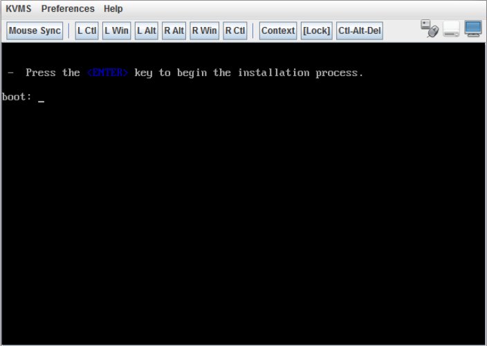

After a few seconds, the splash screen for Oracle VM Server appears.
If you do not press a key, after one minute, the installer automatically starts. The installer is only available in text mode.
