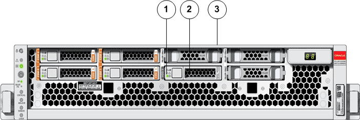

Each Controller has an HDD that is located inside the Controller’s drive compartment. The Controller HDD is a customer replaceable unit (CRU). Replacing the Controller HDD does not require you to bring the Controller offline. The following figure identifies the location of the Controller HDD.
Figure 1 Controller HDD location  Controller HDD location
Legend
1 Controller HDD
2 Controller HDD LEDs
3 Controller drive compartment
