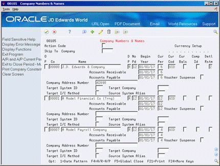

To activate One Time Payment functionality
From General Accounting (G09), choose Organization & Account Setup
From Organization & Account Setup (G09411), choose Company Numbers & Names
On Company Numbers and Names (P00105)
Figure 9-1 Company Numbers and Names screen
Access the detail information (F4) for company 00000.
In the Company Address Number field, enter the OTP address number.
Example: Address Book number 42690 has been added with Alpha/Mailing name of OTP. On the Company Numbers and Names screen, address number 42690 displays in the Company Address Number field for company 00000.
