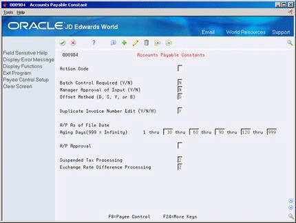

Constants provide a basic framework for how your Accounts Payable system works, based on your business needs.
Setting up accounts payable constants consists of:
Setting up batch control
Setting up management approval
Setting up the automatic offset method
Setting up invoice number editing
Setting up time intervals for A/P aging reports
Setting up Suspended Tax Processing
Setting up Exchange Rate Difference Processing
Information about constants is stored in the General Constants table (F0009).

Figure 61-1 Accounts Payable Constants screen
You might want to track the total number of vouchers and total amount for a batch of vouchers and then verify those totals after you complete entering a batch.
Complete the following field:
Batch Control Required
You can specify that management approves each batch of vouchers before they are posted. Management approval allows you to designate a default status for your batches. The default statuses are:
On Accounts Payable Constants
Manager Approval of Input

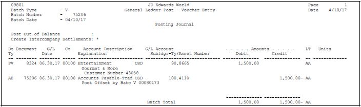

The following report shows a journal entry that the system created as an automatic offset using the batch method. The system uses the batch number for the document number of the automatic offset, rather than the document number of the transaction as with the other Offset methods.
Figure 61-2 General Ledger Post - Voucher Entry screen
