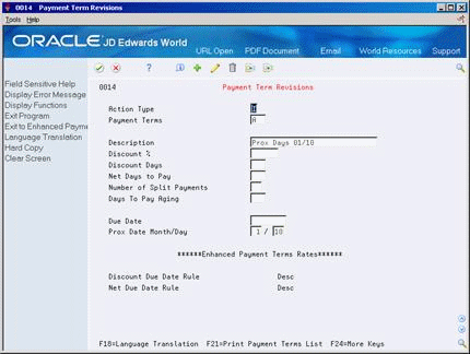

To set up proximate date payment terms
A supplier might specify a voucher due date by indicating the proximate, or subsequent, month and day. The system calculates the month that the voucher is due by adding the proximate month to the month of the invoice date. The proximate day is the date in that month.
For example, an invoice date is May 20, the proximate month is 1, and the proximate day is 10. In this case, the payment is due on June 10.
On Payment Terms Revisions
Figure 65-4 Payment Term Revisions screen (with Prox Date field completed)
Description of Figure 65-4 follows
Description of "Figure 65-4 Payment Term Revisions screen (with Prox Date field completed)"
  1. Complete the following fields:
    • Payment Terms
    • Proximate Date Month
    • Proximate Date Day
  2. Complete the following optional field:
    • Description
Field Explanation
Proximate Date Month This field represents the month increment of the proximate due date. For example, a proximate date of 01/15 indicates that the payment is due on the 15th of next month. A proximate date of 03/10 means the payment is due three months hence on the 10th.
Proximate Date Day This field represents the day increment of the proximate due date. For example, a proximate date of 01/15 indicates that the payment is due on the 15th of next month. A proximate date of 03/10 means the payment is due three months hence on the 10th.

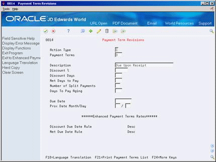

To set up due upon receipt payment terms
A supplier might expect payment upon receipt of a voucher/invoice. For due upon receipt payment terms, the system sets the due date equal to the invoice date.
For example, if the invoice date is June 10, the due date is June 10. If there is no invoice date, the system uses the G/L date.
Figure 65-5 Payment Term Revisions screen
Description of Figure 65-5 follows
Description of "Figure 65-5 Payment Term Revisions screen"
  1. Complete the following field:
    • Payment Terms
    • Description
  3. Leave the following fields blank:
    • Due Date
    • Net Days to Pay

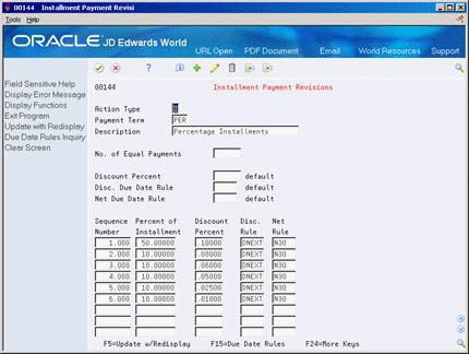

To set up split payment terms
Instead of paying all of a voucher at one time, you might arrange with a supplier to pay a voucher with equal, consecutive payments. To do this, set up split payment terms.
For example, a voucher has an invoice date of July 1, two equal payments are due, and the number of days between payments is 30. In this case, the first payment is due July 31, 30 days from the invoice date. The second payment is due August 30, 30 days from the first payment due date.
If the supplier allows a discount, the system applies the entire discount to the first pay item.
Figure 65-6 Payment Term Revisions seen
Description of Figure 65-6 follows
Description of "Figure 65-6 Payment Term Revisions seen"
    • Payment Terms
    • Net Days to Pay
    • Number of Split Payments
    • Days to Pay Aging
  2. Complete the following optional fields:
    • Description
Field Explanation
Number of Split Payments The number of equal, consecutive payments that the system divides the voucher into. For example, if the payment terms are 1/3, 1/3, 1/3 due in 30, 60, 90 days, respectively, the number of split payments is 3. Days to pay aging, then, is 30.
You can use split payments only if the number of days between payments is a constant number, such as 30.
Days to Pay Aging The number of days that the system uses to calculate the due date for each payment if you are using split payments. For example, if the payment terms are 1/3, 1/3, 1/3 due in 30, 60, and 90 days, respectively, the number of split payments is 3, and the days to pay aging is 30 (30 days between payments).

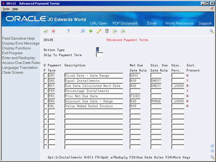

65.3 Setting Up Advanced Payment Terms
Payment terms can range from simple to complex, depending on the policy of your organization. For example, you might set up a simple payment term such as 1/10, net 30 to encourage early payment. You might also set up a more complex or advanced payment term to allow an invoice or a voucher to be split into multiple payments with a different discount percentage for each payment.
Payment terms provide you with the flexibility to define how the system calculates due dates and discount percentages for your invoices and vouchers. A due date can either be a net due date or a discount due date. Because of the complex and diverse ways of calculating due dates, you can set up due date rules using various components to calculate a due date. For example, you can specify that the system add 10 days to the based on date, which might be the G/L date, when calculating the discount due date of an invoice.
After you set up due date rules for both the net due date and the discount due date, you set up the payment term code. You can specify a due date rule as either a discount due date or a net due date. This enables you to link the rules together with a discount percent to define the:
  • Default payment term code for a customer or supplier
  • Payment term code of a specific invoice or voucher
The system stores payment term information in the following tables:
  • Advanced Payment Terms (F00141)
  • Due Date Rules (F00142)
  • Due Date Rules Day Range (F00143)
  • Installment Payment Terms (F00144)

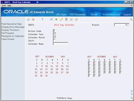

Work Day Calendar This is a calendar that you can use to ensure that the due date is on a work day.
Work Day Rule This is a rule that you can use to ensure that if a due date is on a non-work day, the system moves it forward or backward to an actual working day. It also determines whether to count non-work days when calculating the due date.

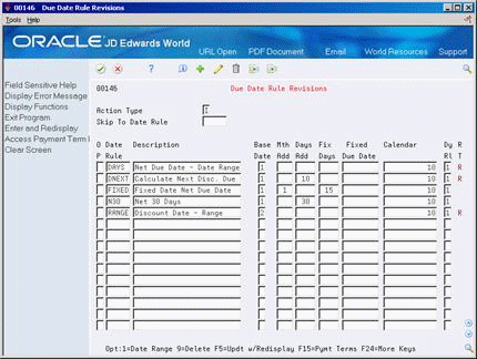

To set up due date rules
On Due Date Rule Revision
Figure 65-7 Due Date Rule Revision screen
Description of Figure 65-7 follows
Description of "Figure 65-7 Due Date Rule Revision screen"
    • Date Rule
    • Description
  2. To define how the system calculates the due date, complete any of the following fields:
    • Based on Date
    • Months to Add
    • Days to Add
    • Fix Days to Use
  3. To specify information about a work day calendar, complete the following fields:
    • Calendar
    • Work Day Rule
  4. To set up a date range as part of your due date rule, choose the Date Range option next to the rule.
    Figure 65-8 Date Range Set-Up screen
    Description of Figure 65-8 follows
    Description of "Figure 65-8 Date Range Set-Up screen"
  5. On Date Range Setup, complete the following fields:
    • From Day Range
    • To Day Range
  6. Complete the following optional fields, and press Enter:
    • Add Months
    • Add Days
    • Fixed Days
  7. Choose the Update function to update and redisplay the due date rule.
Field Explanation
Date Rule The due date rule that the system uses to determine the installment due date of an invoice. You define due date rules on the Due Date Rule Revisions form.
Description A user defined name or remark.
Based on Date The initial date from which the net due date and discount due date is calculated.
Note: The based on date attached to the net due date rule and the discount due date rule is applicable for the first installment only for installment payment terms. Each subsequent installment will use the previously calculated net due date as the basis for calculating the next due date.
Mth Add This field indicates the number of months to add to the based on date to determine the net due date or the discount due date.
Days Add This field indicates the number of days to add to the based on date to determine the discount or net due date.
Fix Days This indicates the fixed day which will be used during the date calculation.
Calendar The calendar name to be used in work day calculations. It will be validated against the Work Day table (F0007).
Work Day Rule A code that controls how the system determines the due date when the due date falls on a non-working day. The work day rule operates in conjunction with the fixed days, add days, and date range.
Valid values:
blank – When calculating the due date, use actual days. Ignore day classifications, such as working day, weekend, and holiday.
1 – When calculating the due date, omit non-working days. If the due date falls on a non-working day, move the due date forward to the next working day.
2 – When calculating the due date, use actual days. If the due date falls on a non-working day, move the due date forward to the next working day.
3 – When calculating the due date, do not omit non-working days. If the due date falls on a non-working day, move the due date back to the last working day.
From This field indicates the lower value of a day range. The allowable values are 1 to 31. This must be lower than the To Day value.
To This field indicates the upper value of a day range. The allowable values are 1 to 31. This must be greater than the From Day value.

To set up work day calendars
On Work Day Calendar
Figure 65-9 Work Day Calendar screen
Description of Figure 65-9 follows
Description of "Figure 65-9 Work Day Calendar screen"
    • Branch
    • Calendar Year
    • Calendar Month
    The calendar for the month and year displays twice. The left portion of the form shows the numerical days, and the right portion of the form shows the workdays and non-workdays.
  2. In the right portion of the form, change the default values as necessary for each day of the week.
65.5.1 What You Should Know About
Topic Description
Specifying the type of day Some examples of the type of day you can specify on the calendar are as follows:
  • W (workday)
  • E (weekend)
  • H (holiday)
  • S (shut-down)
The Work Day Calendar program (P00071) The Work Day Calendar program is a Manufacturing program. On the Work Day Calendar form, the Branch field does not refer to a Branch/Plant (business unit). Instead, it refers to the name that you assign to the work day calendar for your due date rules.
Therefore, when you set up a work day calendar, the system accesses it from the Work Day Calendar table (F0007), not the Business Unit table (F0006).

To set up payment term codes
On Advanced Payment Terms
Figure 65-10 Advanced Payment Terms screen
Description of Figure 65-10 follows
Description of "Figure 65-10 Advanced Payment Terms screen"
    • Payment Term
    • Description (optional)
  2. To attach a due date rule to the payment term, complete the following fields:
    • Net Due Date Rule
    • Discount Due Date Rule
  3. To specify a discount percentage for the invoice, complete the following field:
    • Discount Percentage
Field Explanation
Payment Term A code that specifies the terms of payment, including the percentage of discount available if the invoice is paid within a certain amount of time. A blank code usually indicates the most frequently used payment term. You define the specifications for each type of payment term on the Payment Terms Revisions form. For example:
blank – Net 15
1 – 1/10 net 30
2 – 2/10 net 30
N – Net 30
P – Fixed day of 25th
Z – Net 90
This code prints on customer invoices.
Description The text that describes the payment terms code. You can print this text on the invoice, for example, 2/10, net 30, fixed day 25.
Net Due Date Rule The due date rule that the system uses to calculate the net due date of an invoice installment. You define net due date rules on the Due Date Rules Revisions form.
Disc. Due Date Rule The due date rule that the system uses to calculate the discount due date of an invoice. This is similar to a discount due date payment term. You define the discount due date rule on the Due Date Rules Revisions form.
Disc Perc The percent of the total invoice that will be discounted if the invoice is paid within the discount period. This is entered as a decimal, for example, a 2% discount is .02.

To set up installment payments
On Installment Payment Revisions
Figure 65-11 Installment Payment Revisions screen
Description of Figure 65-11 follows
Description of "Figure 65-11 Installment Payment Revisions screen"
    • Payment Terms
  2. To set up equal installment payments with the same due date rules, complete the following fields in the header area:
    • Number of Equal Payments
    • Discount Percent
    • Net Due Date Rule
  3. To set up unequal installment payments or to apply different due date rules, complete the following fields for each installment in the detail area:
    • Sequence Number
    • Percent of Installment
    • Discount Percent
    • Net Due Date Rule
Field Explanation
No. of Equal Payments This field indicates the number of equal installments to be initially generated by the system. Using default values, the system uses this fast path method to create equal installments.
Discount Percent The default value for the percent of the total invoice that will be discounted if the invoice is paid within the discount period. This is entered as a decimal, for example, a 2% discount is .02.
Note: This field is only available the first time that installments are entered for a payment term. It is the value which will initially be replicated for the generated installments.
Disc. Due Date Rule The default value of the discount due date rule that the system uses when generating equal installments.
Note: This field is only available for use when first generating new equal installments for a payment term.
Net Due Date Rule The default value for the Net Due Date rule when generating equal installments.
Sequence Number A number used to organize the table into a logical group for online viewing and reporting.
Percent of Installment The percentage of the invoice that is going to be split to generate one installment. The total of all installments must add up to 100.00 % of the invoice total amount. This is different than the split payment concept where the split is a fixed percent. Here you create installments using variable percentages. If the percent of the installment is 20%, you enter it as 20.
Discount Percent The percent of the total invoice that will be discounted if the invoice is paid within the discount period. This is entered as a decimal, for example, a 2% discount is .02.
65.7.1 What You Should Know About
Topic Description
Verifying installment payments To verify that installment payments are attached to the appropriate payment term, locate the payment term on Advanced Payment Term Revisions and choose the Update function.

Set up multi-tiered due date rules for payment terms that allow multiple discount percentages.
To set up a multi-tiered due date rule
On Due Date Rule Revisions
Figure 65-12 Due Date Rule Revisions screen
Description of Figure 65-12 follows
Description of "Figure 65-12 Due Date Rule Revisions screen"
    • Date Rule
    • Description
    • Based on Date
    • Months to Add
    • Days to Add
    • Fix Days to Use
    • Calendar
    • Work Day Rule
  4. Choose the Add Multi-Tiered Information option.
    Figure 65-13 Multi-Tiered Due Date Rule screen
    Description of Figure 65-13 follows
    Description of "Figure 65-13 Multi-Tiered Due Date Rule screen"
  5. On Multi-Tiered Due Date Rule, complete the following fields:
    • Day Range From
    • Day Range To
    • Discount Percent
Field Explanation
From Day Enter the from day value for the first tier. This must be equal to 1 as it is the first tier.
To Day Enter the day value for the end day of the first tier. This must be greater than the from day value for this tier. There must be no overlaps and no gaps.
Discount % - Payment Terms The percent of the total invoice that will be discounted if the invoice is paid within the discount period specified by the first tier. This is entered as a decimal, for example, a 2% discount is .02.
