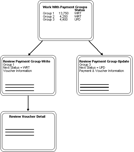

The following graphic shows the relationships among the forms that you use to work with payment groups.
Figure 29-1 Relationship of Forms Used in Payment Groups
The following graphic shows the principal steps for processing payment groups.
Figure 29-2 Principal Steps in Processing Payment Groups

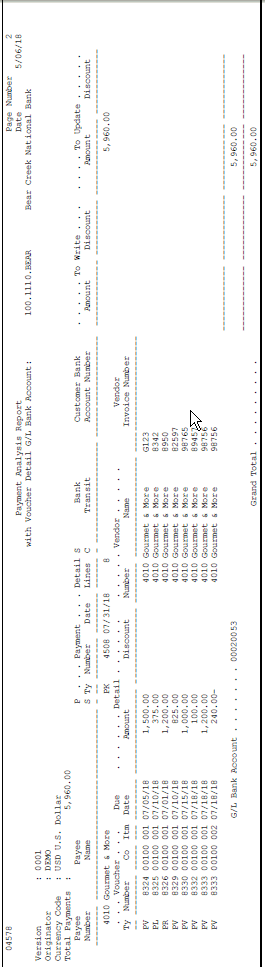

You can print the Payment Analysis Report at any time in the automatic payment process to ensure that payments are correct. This report shows whether payments are ready to be written or ready to be updated to the A/P ledger. It shows all payments in all payment groups.
This program displays and updates information in the following temporary worktables:
A/P Payment Header (F04572)
A/P Payment Control Group (F04571)
A/P Payment Detail (F04573)
This is a DREAM Writer report.
Figure 29-3 Payment Analysis Report with Vendor Detail G/L Bank Account

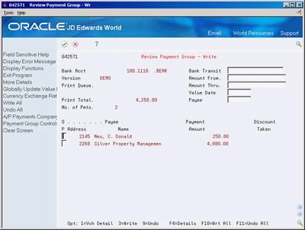

On Review Payment Group - Write, you can change the value in the Sequence field to toggle the display of payments between address book number or alpha name.
Choose Payments for a payment group with a WRT status.
Figure 29-5 Review Payment Group - Write screen

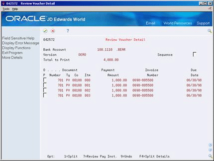

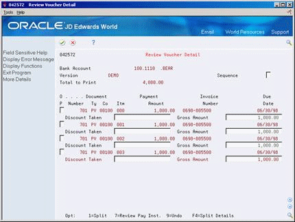

On Review Payment Group - Write, choose Voucher Detail for a payment.
On Review Voucher Detail, you may choose to view vouchers sequenced by Document Number order or by Discount Due Date order. Set the Sequence field according to your preference.

On Review Voucher Detail, choose Split Detail.
Figure 29-7 Review Voucher Detail screen (Split Detail area)
Choose Split for a voucher.
Complete the following field:
Gross Amount

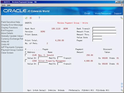

On Review Payment Group - Write, access the detail area.
Figure 29-8 Review Payment Group - Write screen (Detail area)

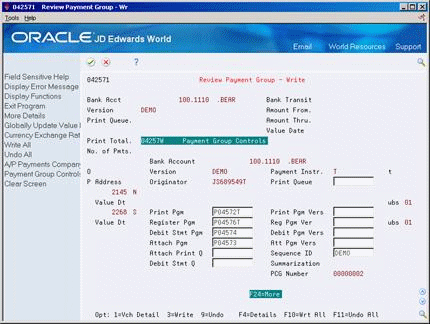

To change the payment instrument, payment register, attachments, debit statements, and print queues for payments, change the control information for the payment group. The system uses payment instrument defaults to create this information when you create payment groups. You can change it before you write payments. Use Field Sensitive Help (F1) in any of the fields on the right side of the window to choose different formats and values. Any change you make affects the entire payment group.
To revise control information for a payment group
On Work with Payment Groups
On Review Payment Group - Write; choose Payment Group Controls for a payment group.
Figure 29-9 Review Payment Group - Write screen (Payment Group Controls area)
On Payment Group Controls, change any of the following fields:
Payment Instrument
Print Queue
Print Program
Register Program
Attachment Program
Debit Statement Program
Sequence ID
Attachment Print Queue
Debit Statement Print Queue
Exit to Review Payment Group - Write.
