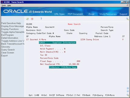

After you update YTD voucher amounts, you might want to review the updated information. You can:
Review supplier balances online
Review supplier balances on a report
Update YTD voucher amounts to update supplier records with year-to-date and prior year-end amounts
To review supplier balances online
From Accounts Payable (G04), choose Supplier & Voucher Entry
From Supplier & Voucher Entry (G0411), choose Supplier Master Information
On Supplier Master Information or any form that displays the supplier number
Position your cursor in the following field and choose Field Sensitive Help:
Supplier Number
On Name Search, complete the following field (or portion thereof) and press Enter:
Alpha Name
Enter 17 in the Option field for a supplier to access Supplier Information.
On Supplier Information, scroll down to review additional information.
