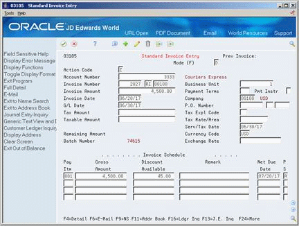

To change a posted invoice
On Standard Invoice Entry
Figure 14-1 Standard Invoice Entry (Revise) screen
Description of Figure 14-1 follows
Description of ''Figure 14-1 Standard Invoice Entry (Revise) screen''
  1. Locate the invoice.
  2. Change the information in any field that is not a key field.
  3. Press Enter to access AR and AP Journal Entries.
  4. On AR and AP Journal Entries, complete the following fields to create a balancing entry, if necessary:
    • Account Number
    • Amount
    • Explanation 2 (optional)
