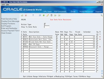

72.2 Setting Up Due Date Rules
Navigation
From Accounts receivable (G03), enter 29
From Accounts Receivable Setup (G0341), choose Payment Terms Revisions
From Payment Terms Revisions (G00141), choose Due Date Rule Revisions
Before you set up specific payment terms, you must define the rules that the system uses to calculate due dates for invoices and vouchers. You can set up as many due date rules as necessary.
A due date rule can consist of any of the following components:
Component Description
Based on Date This can be an invoice date, G/L date, a service tax date, and so on.
Days to Add This is the number of days that the system adds to the based on date.
Months to Add This is the number of months that the system adds to the based on date.
Fixed Days This is the same day every month, such as the 10th or 15th of each month.
Date Range This is a range of days that the system uses in conjunction with other components.
Work Day Calendar This is a calendar that you can use to ensure that the due date is on a work day.
Work Day Rule This is a rule that you can use to ensure that if a due date is on a non-work day, the system moves it forward or backward to an actual working day. It also determines whether to count non-work days when calculating the due date.
By using a combination of these components, you can set up a variety of payment terms. For example, you might set up date rules as follows:
  • Use the invoice date as the based on date and add one month. For example, if the date of the invoice is June 25th, the due date is July 25th.
  • Use the G/L date as the based on date, and add one month and five days. For example, if the G/L date is June 12th, the due date is July 17th.
  • Use the G/L date as the based on date, set up a day range, and specify a number of days to add to the day range and a month to add. For example, if the G/L date is June 2nd, the month to add is 1, and the date ranges are:
    • The 1st through the 10th, add 5 days
    • The 11th through the 31st, use the 31st as the fixed day
    Since the based on date is within the first date range, the system adds five days and one month to the last day in the date range. Therefore, the due date for the payment is July 15th. This is commonly known as a "swing payment term," and is most often used in Germany.
To set up due date rules
On Due Date Rule Revision
Figure 72-1 Due Date Revisions screen
Description of Figure 72-1 follows
Description of ''Figure 72-1 Due Date Revisions screen''
  1. Complete the following fields:
    • Date Rule
    • Description
  2. To define how the system calculates the due date, complete any of the following fields:
    • Based on Date
    • Months to Add
    • Days to Add
    • Fix Days to Use
  3. To specify information about a work day calendar, complete the following fields:
    • Calendar
    • Work Day Rule
  4. To set up a date range as part of your due date rule, choose the Date Range option next to the rule.
    Figure 72-2 Date Range Set-Up screen
    Description of Figure 72-2 follows
    Description of ''Figure 72-2 Date Range Set-Up screen''
  5. On Date Range Setup, complete the following fields:
    • From Day Range
    • To Day Range
  6. Complete the following optional fields, and press Enter:
    • Add Months
    • Add Days
    • Fixed Days
  7. Choose the Update function to update and redisplay the due date rule.

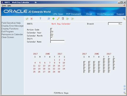

72.3 Setting Up Work Day Calendars
Navigation
From Payment Terms Revisions (G00141), choose Work Day Calendar
When setting up due date rules for your payment terms, you can set up workday calendars. These calendars enable you to specify the actual work days, weekends, holidays, and so on of your organization. You can set up multiple calendars and reference the name of one in the due date rule.
After you set up a work day calendar, you specify which action to take if the system calculates the due date on a non-work day. You do this on the Due Date Rule Revisions form. For example, you can instruct the system to:
  • Ignore non-work days when counting the days to calculate the due date and not allow the due date to occur on a non-work day.
  • Use the work day after the calculated due date as the due date. For example, if the calculated due date occurs on the weekend, the system moves it to the following Monday.
  • Use the work day before the calculated due date as the due date. For example, if the calculated due date falls on the weekend, the system moves it to the previous Friday.
If you specify a work day rule, you can adjust the payment's due date to correspond with your working days. For example, you can prevent unintended "grace periods" that might occur if the due date falls on a Saturday and your business is closed. In addition, you can specify that the payment is due in 30 working days instead of 30 calendar days.
To set up work day calendars
On Work Day Calendar
Figure 72-3 Work Day Calendar screen
Description of Figure 72-3 follows
Description of ''Figure 72-3 Work Day Calendar screen''
    • Branch
    • Calendar Year
    • Calendar Month
    The calendar for the month and year displays twice. The left portion of the form shows the numerical days, and the right portion of the form shows the workdays and non-workdays.
  2. In the right portion of the form, change the default values as necessary for each day of the week.

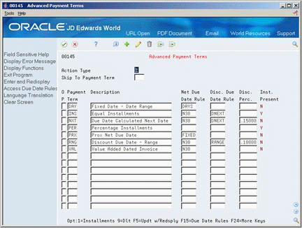

72.4 Setting Up Payment Term Codes
Navigation
From Payment Terms Revisions (G00141), choose Advanced Payment Terms
You can set up codes for various payment terms, which determines the net due dates, discounts, and discount due dates for your invoices and vouchers. This makes entering invoices and vouchers more efficient.
When you enter a customer or supplier record, you specify the payment term code that the customer or supplier uses most frequently. Then, when you enter the invoice or voucher, you can either:
  • Accept the default payment term code
  • Designate a different payment term code
72.4.1 Payment Term Codes
When you set up a payment term code, you can use a one-, two- or three-character combination of the following:
  • Alphabetic (A - Z)
  • Numeric (1 - 999)
  • Special characters (including blank)
You should set up a blank code for the most commonly used payment terms. If you do this, you must also set up a non-blank code for the same payment terms in case you need to change a supplier's payment terms later.
For example, you have a supplier with a payment terms code of D (due upon receipt). The supplier changes the terms to net 30 days, which is set up as a blank code. Because you cannot replace the existing code of D with a blank, you must use a non-blank code, such as N for net 30 days.
72.4.2 Before You Begin
  • Set up the necessary due date rules that the system uses to calculate net due dates and discount due dates. This enables the system to link the rule to a specific payment term. See Section 72.2, "Setting Up Due Date Rules" for more information.
To set up payment term codes
On Advanced Payment Terms
Figure 72-4 Advanced Payment Terms screen
Description of Figure 72-4 follows
Description of ''Figure 72-4 Advanced Payment Terms screen''
    • Payment Term
    • Description (optional)
  2. To attach a due date rule to the payment term, complete the following fields:
    • Net Due Date Rule
    • Discount Due Date Rule
  3. To specify a discount percentage for the invoice, complete the following field:
    • Discount Percentage

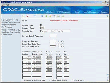

72.5 Setting Up Installment Payments
Navigation
From Payment Terms Revisions (G00141), choose Installment Payment Revisions
Instead of a customer or you paying all of an invoice or voucher at one time, you can arrange installment payments. You can set up installment payment terms to pay an invoice or voucher with multiple payments over a specified period of time.
When you set up installment payment terms, you can set up equal payments or unequal payments with different percentages. You can also specify a different discount percent for each installment. The system calculates the due date of each installment based on the due date rule you assign to it.
The following describes two examples of installment payment terms:
Term Description
Equal payments with a discount due date You might set up five equal payments. Each payment includes a ten percent discount if paid within the discount period that you defined in the discount due date rule.
The actual due date of the payment depends on the net due date rule that you set up.
Unequal payments with a discount due date You might set up six payments. Five of the payments might be 15 percent of the invoice amount, and the sixth payment is 25 percent. Each payment might also include a five percent discount if paid within the discount period that you defined in the discount due date rule.
To set up installment payments
On Installment Payment Revisions
Figure 72-5 Installment Payment Revisions screen
Description of Figure 72-5 follows
Description of ''Figure 72-5 Installment Payment Revisions screen''
    • Payment Terms
  2. To set up equal installment payments with the same due date rules, complete the following fields in the header area:
    • Number of Equal Payments
    • Discount Percent
    • Net Due Date Rule
  3. To set up unequal installment payments or to apply different due date rules, complete the following fields for each installment in the detail area:
    • Sequence Number
    • Percent of Installment

No. of Equal Payments This field indicates the number of equal installments to be initially generated by the system. Using default values, the system uses this fast path method to create equal installments.
Discount Percent The default value for the percent of the total invoice that will be discounted if the invoice is paid within the discount period. This is entered as a decimal, for example, a 2% discount is .02.
Note: This field is only available the first time that installments are entered for a payment term. It is the value which will initially be replicated for the generated installments.
Disc. Due Date Rule The default value of the discount due date rule that the system uses when generating equal installments.
Note: This field is only available for use when first generating new equal installments for a payment term.
Net Due Date Rule The default value for the Net Due Date rule when generating equal installments.
Sequence Number A number used to organize the table into a logical group for online viewing and reporting.
Percent of Installment The percentage of the invoice that is going to be split to generate one installment. The total of all installments must add up to 100.00 % of the invoice total amount. This is different than the split payment concept where the split is a fixed percent. Here you create installments using variable percentages. If the percent of the installment is 20%, you enter it as 20.
Discount Percent The percent of the total invoice that will be discounted if the invoice is paid within the discount period. This is entered as a decimal, for example, a 2% discount is .02.
72.5.1 What You Should Know About
Topic Description
Verifying installment payments To verify that installment payments are attached to the appropriate payment term, locate the payment term on Advanced Payment Term Revisions and choose the Update function.

Set up multi-tiered due date rules for payment terms that allow multiple discount percentages.
To set up a multi-tiered due date rule
On Due Date Rule Revisions
    • Date Rule
    • Description
    • Based on Date
    • Months to Add
    • Days to Add
    • Fix Days to Use
    • Calendar
    • Work Day Rule
  4. Choose the Add Multi-Tiered Information option.
    Figure 72-6 Multi-Tiered Due Date Rule screen
    Description of Figure 72-6 follows
    Description of ''Figure 72-6 Multi-Tiered Due Date Rule screen''
  5. On Multi-Tiered Due Date Rule, complete the following fields:
    • Day Range From
    • Day Range To
    • Discount Percent
Field Explanation
From Day Enter the from day value for the first tier. This must be equal to 1 as it is the first tier.
To Day Enter the day value for the end day of the first tier. This must be greater than the from day value for this tier. There must be no overlaps and no gaps.
Discount % - Payment Terms The percent of the total invoice that will be discounted if the invoice is paid within the discount period specified by the first tier. This is entered as a decimal, for example, a 2% discount is .02.
