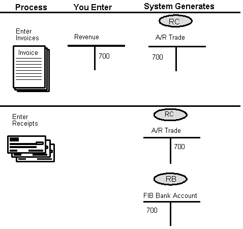

Automatic accounting instructions (AAIs) define the relationships between your day-to-day accounting functions and your chart of accounts. Each system that interfaces with the JD Edwards World General Accounting system has AAIs.
The system uses a company and AAI item combination to determine which account to use. For example, AAIs tell the system which A/R asset account to debit when posting invoices or which bank account to debit when posting receipts.
Information about AAIs is stored in the Automatic Accounting Instructions Master table (F0012).
AAI items for accounts receivable always start with the letter R. For example, RC is the receivables class account and RB is the receivables bank account.
The name of an AAI item, such as RC, is hard coded. Each AAI item has account codes consisting of a business unit, object, and subsidiary, which are mapped to your chart of accounts.

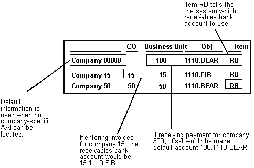

This AAI can be set up for use with a G/L offset or without. The G/L offset field is a four-character alphanumeric field that can be established in the Customer Master file (F0301) to be populated in the AR Ledger file (F0311). If the G/L offset has a value, a corresponding AAI for item RCyyyy (where yyyy = value in G/L offset field) must exist. You can establish RCyyyy for a specific company or for company 00000 only. If the AAI RCyyyy has not been set up at the time the invoice is entered (or processed, if using Batch Invoice Processing), the system will return an error.
If the Customer Master or Invoice does not have a value in the G/L offset field, the AAI item for RC is used. This can be established for each company or for company 00000.
The minimum account requirement for this AAI is Object Account. If the Business Unit field is left blank, the system will link the business unit for the invoice transaction with the Object (or Object/Subsidiary) entered in the AAI item to use as the offset account. If this account does not exist in the Account Master (F0901) file, an error will be returned at the time the invoice is entered or processed.
If multi-currency is used, the program searches for an AAI for the specific company for RBxxx (where xxx is equal to the currency code entered on the invoice). If a company specific AAI does not exist, the program searches for the AAI for RBxxx for company 00000. If this AAI does not exist, the system searches the G/L offset field to see if a value exists.
There must be a value in the G/L offset field and both RCyyyy and RByyyy (where yyyy = value in the offset field) must be set up for the system to use RByyyy. If RByyyy exists, but RCyyyy does not exist, the system will return an error at the time the invoice is entered or processed.

The following illustrates how the Accounts Receivable system searches the AAIs for instructions.
Figure 73-1 Searching AAIs for Instructions in the Accounts Receivable System
Your system comes with AAIs that are already assigned to company 00000. You should customize these AAIs to fit your company, business unit, or object account setup.
You must assign the default AAIs for company 00000 to a valid account in your chart of accounts. If the system cannot find an AAI for a specific company, it uses the AAI for company 00000. You do not need to set up an AAI for any company that uses the default AAI.
The following example uses company 00100 and A/R class code TRAD to show the sequence that the system uses to search for AAIs:
Search for company 00100, item RCTRAD.
If not found, search for company 00000, item RCTRAD.
If not found, search for company 00100, item RC____.
If not found, search for company 00000, item RC____.
If not found, there is an error in the AAI setup.
