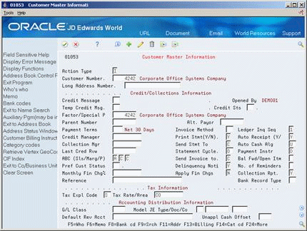

You can set a default payment instrument to use for each customer. The system displays the default payment instrument when you enter invoices for that customer. This saves data entry time when entering invoices.
For drafts, this payment instrument indicates whether you plan to send drafts attached to the customer's invoices or statements. The draft payment instrument can be any of the following:
  • D (draft by invoice)
  • F (draft by statement)
  • 0 (magnetic draft)
Occasionally, the customer might use another form of payment. You can use Speed Status Change to change the payment instrument on an invoice-by-invoice basis. You can also use this program to update the discount available, remark, pay status, and/or due date.
To set up drafts as the default payment instrument
On Customer Master Information
Figure 79-1 Customer Master Information screen
Description of Figure 79-1 follows
Description of ''Figure 79-1 Customer Master Information screen''
Complete the following field:
  • Payment Instrument

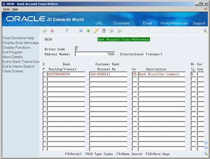

Bank Account Cross Reference updates the Bank Transit Number Master table (F0030). Alternatively, you may access Bank Accounts by Address from Customer Master by using the Bank Code function (F8). The program is the same (P0030) regardless of how you access it.
To set up cross-references for A/R drafts bank accounts
On Bank Account Cross-Reference
Figure 79-2 Bank Account Cross-Reference screen
Description of Figure 79-2 follows
Description of ''Figure 79-2 Bank Account Cross-Reference screen''
  1. Complete the following fields:
    • Address Number
    • Routing/Transit Number
    • Account Number
    • Control Digit (optional)
    • Description (optional)
    • Bank Type
    • Currency Code (optional)

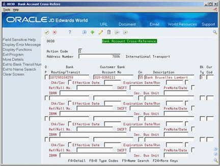

  2. Access the detail area.
    Figure 79-3 Bank Account Cross-Reference (Detail) screen
    Description of Figure 79-3 follows
    Description of ''Figure 79-3 Bank Account Cross-Reference (Detail) screen''
  3. Complete the following fields:
    • SWIFT Code (optional)
    • Checking or Savings Account
    • Reference/Roll Number
    • Effective date (optional)
    • Expiration date (optional)

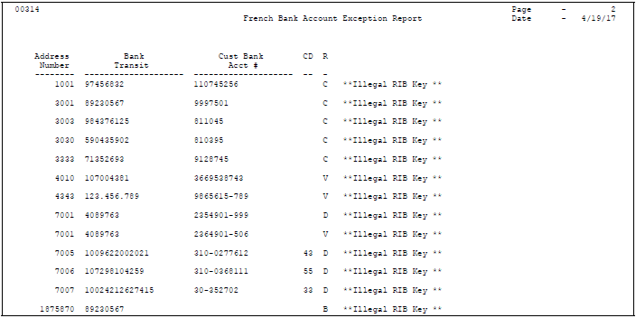

The Bank Account Exception Report lists all bank account records that have either an illegal French RIB key or a transit number that does not have an associated type B record.
Two versions of this report are available:
Version Description
Italian When you run this version, the system searches for a bank account type B to verify the bank transit account number of your customer's bank type D accounts.
French When you run this version, the system searches for an illegal French RIB number in the bank transit number.
Regardless of which version you run, the system bypasses bank account numbers that do not have address numbers.
To correct bank account information that appears on this report, use Bank Account Cross-Reference or Address Book Revisions.

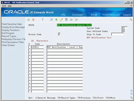

When a customer has an outstanding draft because of insufficient funds, you can send a notification letter. The text that prints on the letter must first be defined using NSF Notification Generic Text.
You create codes that indicate the severity of your warning (for example, LEVEL 1 for a first letter, LEVEL 2 for a second letter, and so on), then define the text for each code. When you run NSF Notification to create your notification letters, you enter a code in the processing options. The system prints a letter using the text associated with that code.
To set up letters for non-sufficient funds
On NSF Notification Generic Text
Figure 79-5 NSF Notification Generic Text screen
Description of Figure 79-5 follows
Description of ''Figure 79-5 NSF Notification Generic Text screen''
  1. To add a code, complete the following fields:

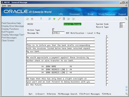

  2. To define text for a code, choose the General Message option next to that code.
    Figure 79-6 General Message screen
    Description of Figure 79-6 follows
    Description of ''Figure 79-6 General Message screen''
  3. On General Message, do one of the following:
    • Type new text for a code and use the Add action
    • Type over the existing text and use the Change action
