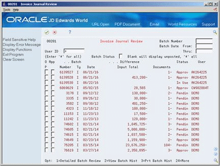

On Auto Debit Journal Review
Figure 100-1 Invoice Journal Review (Automatic Debits) screen
Description of Figure 100-1 follows
Description of ''Figure 100-1 Invoice Journal Review (Automatic Debits) screen''
  1. Display all batches for all users, or complete any of the following fields to limit the information displayed:
    • User ID
    • Batch Number
    • Batch Date From:
    • Batch Date Thru:
    • Batch Status
  2. To approve an automatic debit, complete the following field:
    • Approval
