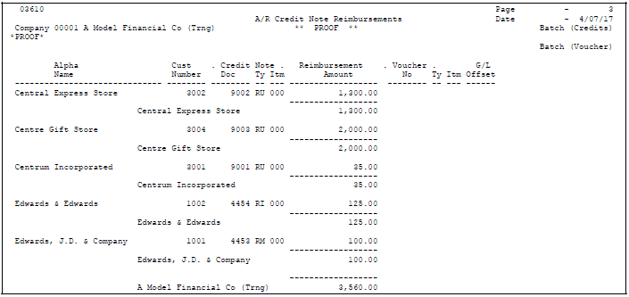

The system prints the following report in proof mode. You can use this report to review your credit note reimbursements before processing them.
Figure 60-2 A/R Credit Note Reimbursements report

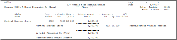

The system prints the following report in final mode. You can use this report to review the credit note reimbursements that are processed.
Figure 60-3 A/R Credit Note Reimbursements (Final) report
