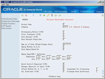

The following describes why you would set up batch control and when you would use it.
Use batch control to verify that the batch of invoices you enter into the system balances to a manual record of the batch. You activate batch control in the Accounts Receivable constants. Batch control information is stored in the Batch Control table (F0011).
Figure 6-1 Accounts Receivable Constants screen

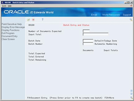

If you set the appropriate A/R constant, the system displays a screen that you use to enter information about your invoices before you actually enter them. Once you enter the information, the system compares the control totals with the actual totals you entered for the batch. If the totals are not the same, it displays the difference.
Figure 6-2 Batch Entry and Status screen
