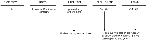

The following graphic illustrates a company's balance condition.
Figure 11-1 Example of a Company's Balance Condition
The report provides the following amounts:
| Amount | Explanation |
| Prior Year | The balance forward amount for the current year (updated during annual close). |
| YTD (Year to Date) | The amount at the beginning of the fiscal year through the current period. |
| PACO (Post After Cut Off) | The amount beyond the current period into the next fiscal year. |
If any companies are out-of-balance, the summarized amounts are in the columns. The system accumulates a total difference amount for all companies for each of the three columns. When companies are in balance, the columns are blank.

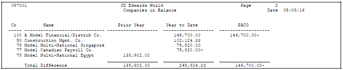

After running the Companies in Balance integrity report, you should correct any discrepancies that the system detects. Some typical discrepancies, causes, and possible resolutions follow, along with an example from the report.
Example 1: YTD and PACO total are out of balance by opposite amounts for the same company
| Discrepancy | Reason / Resolution |
| YTD and PACO totals | Reasons:
Resolutions:
This error is usually caused by a leap year. 2016 is used here because it is a leap year. The company's date pattern begins 1 - 01 - 16 and each period ends the last day of the month, as follows:
Period 01 ends 1/31/16
Period 02 ends 2/28/16
Period 03 ends 3/31/16
Period 12 ends 12/31/16
When you enter a voucher for 146,700, the system creates the following journal entries:
G/L Date Doc Type Amount Period
2/29/16 PV 146,700 03
3/31/16 AE -146,700 03
The 146,700 PV document is in period 03 because of the date pattern. The -146,700 AE document is posted with a G/L date of 3/31/16, the last day of the period when posting by the batch method.
