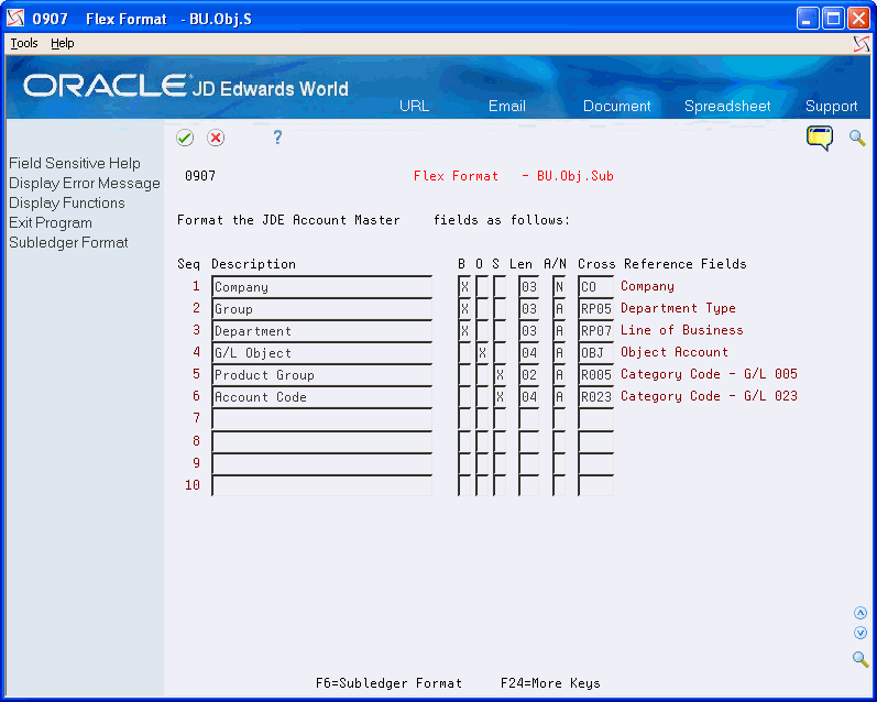

On Flex Format - BU.Obj.Sub
Figure 20-1 Flex Format - BU.Obj.Sub screen
Description of Figure 20-1 follows
Description of "Figure 20-1 Flex Format - BU.Obj.Sub screen"
  1. Complete the following fields (cross reference may be either a business unit or an account code):
    • Description
    • Len (Length)
    • A/N (Alpha/Numeric)
    • Cross (Cross Reference)
  2. To indicate how to map the flexible segment to the standard format segment, complete one of the following fields:
    • B (Business Unit)
    • O (Object)
    • S (Subsidiary)
Field Explanation
Description A user defined name or remark.
Form-specific information
You can enter the segments in any order on the form.
B (Business Unit Segment Indicator) An X in this field indicates that this segment of each G/L account number is stored as part of the JD Edwards World Business Unit field (MCU) in the database. For flex account numbers, you can define up to 6 segments, and use a total of 12 characters for the Business Unit field.
If you define multiple segments for the business unit, the system concatenates them left to right in ascending order according to their assigned sequence numbers. The resulting number is right-justified in the database field.
O (Object Segment Indicator) An X in this field indicates that this segment of each G/L account number is stored as part of the JD Edwards World Object Account field (OBJ) in the database. For flex account numbers, you can define up to three segments, and use a total of six characters for the Object field.
If you define multiple segments for the object, the system concatenates them left to right in ascending order according to their assigned sequence numbers. The resulting number is left-justified in the database field.
S (Subsidiary Segment Indicator) An X in this field indicates that this segment of each G/L account number is stored as part of the JD Edwards World Subsidiary Account field (SUB) in the database. For flex account numbers, you can define up to four segments and use a total of eight characters for the Sub field.
If you define multiple segments for the subsidiary, the system concatenates them left to right in ascending order according to their assigned sequence numbers. The resulting number is left-justified in the database field.
Len (Length) The length of the specific segment or element for the flexible chart of accounts format. The individual elements must be greater than zero and must not exceed the following number of characters:
Business Unit – 12 (with separator characters)
Object account – 6 (with separator characters)
Subsidiary account – 8 (with separator characters)
Subledger – 8 (separator characters not allowed)
A/N (Alpha/Numeric) A code of A indicates that the field is to be an alphanumeric field. A code of N indicates that the field is defined as a numeric field.
Cross (Data Item Cross-Ref - Business Unit) A code that identifies the field in the Business Unit Master file (F0006) that relates to the flex number segment.
The system uses this cross-reference to map flex account number segments to the bu.obj.sub format. Do not add, change, or delete any cross-reference fields in the user defined codes list.
Cross (Data Item Cross-Ref - Account Code - Object and Subsidiary) The JD Edwards World data field name from the Account Master file (F0901) which relates to the particular account format element. This item is validated against User Defined Codes 09/X2.
Note: These fields are set up for mapping in the programs. Therefore, if other Account Master file fields are added to this user defined code, they will be accepted but information will not be mapped to these fields. Do not add new fields to this user defined code.

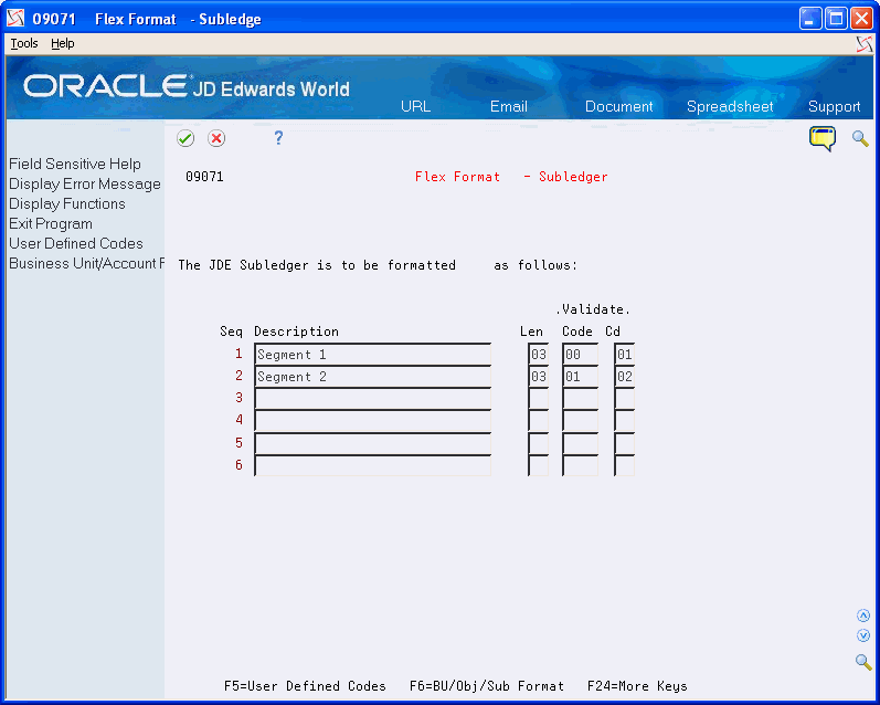

You can define flexible segments that correspond to the subledger. This is an optional feature. You can use flexible format for subledgers only, without setting up a flexible format for the business unit.object.subsidiary segments of your standard format.
Because there are no account master records at the subledger level, you cannot match subledger segments to other fields. The system validates these segments against user defined codes.
When defining subledger segments, note the following:
  • You must use a valid user defined code for the system to validate the subledger segments.
  • If you set up your own user defined code list to validate a segment, you should use install system code 55. This code allows you to set up custom codes that can never be overwritten by JD Edwards World programs.
  • The system edits only subledgers entered with a type S (Flexible), based upon the format you define.
To define a subledger segment
On Flex Format – Subledger
Figure 20-2 Flex Format - Subledger screen
Description of Figure 20-2 follows
Description of "Figure 20-2 Flex Format - Subledger screen"
Complete the following fields:
  • Description
  • Len (Length)
  • Code (System Code)
  • Cd (User Defined Code)
Field Explanation
Code (System Code) A user defined code (98/SY) that identifies a JD Edwards World system.
Enter the install system code for validation. During data entry, the system validates the subledger against the user defined code table you specify (install system code and user defined code type). Leave the Validate fields blank for no validation of the subledger.
Cd (User Defined Codes) Identifies the table that contains user defined codes. The table is also referred to as a code type.
Enter the record type for validation. During data entry, the system validates the subledger against the user defined code table you specify (install system code and record type).

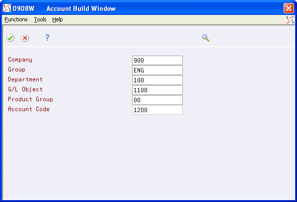

20.5 Entering New Account Numbers
After you define the account segments for your flexible format, enter new account numbers using the Account Build form to ensure that the account numbers conform to the flexible format.
This form only appears if your system is set up for flexible account numbers.
Building the account separates the account segments into individual fields for easy data entry. To access this form, place your cursor in an account field on an entry form (such as Journal Entries), press F1, and then press F8.
The following example shows user-defined segments of a flexible account number 900.ENG.100.1100.00.1200:
Figure 20-3 Account Build Window
