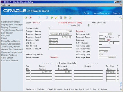

To enter a multi-currency invoice
On Standard Invoice Entry
Figure 15-1 Standard Invoice Entry screen
Follow the steps to enter a standard invoice.
Complete the following fields:
Currency Code
Exchange Rate (optional)

| Field | Explanation |
| Mode | A code that specifies whether amounts are in the domestic currency of the company the invoices are associated with or in the foreign currency of the transaction. Codes are:
D – Domestic F – Foreign Form-specific information When you inquire on an invoice, the default code in this field is that of the original mode of entry. You can enter F or D to specify the display of either the foreign or domestic amounts. |
| Currency Code | Indicates the transaction currency used by the customers. If you leave this field blank, Customer Master provides the default value. If no currency is assigned to the customer, the default value is the currency code of the invoice company. |
| Exchange Rate | The conversion rate that the system uses to convert foreign currencies to domestic currencies. If the Multi-Currency Conversion option on the Set Multi-Currency Option form is set to Y, this rate is a multiplier. If it is set to Z, this rate is a divisor.
Form-specific information If you leave this field blank, the system uses the Currency Exchange Rate table (F0015). The effective date for the exchange rate is either the invoice date or the general ledger date, depending on how the processing options are set in the Default Invoice Server Options (XT0311Z1) and Standard Invoice Entry (P03105. |
