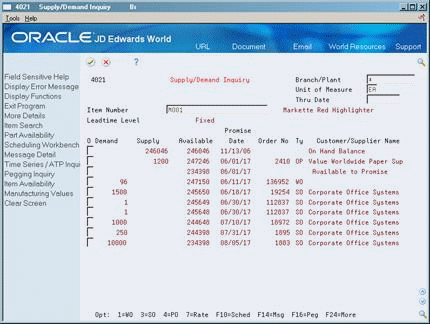

To review supply and demand information
To locate a specific item, complete the following fields:
Branch/Plant
Item Number
To limit the items that display, complete the following fields:
Unit of Measure
Thru Date
Review the following fields:
Demand
Supply
Available
Promise Date
Order No
Ty (Type)
Customer/Supplier Name
Press Enter.

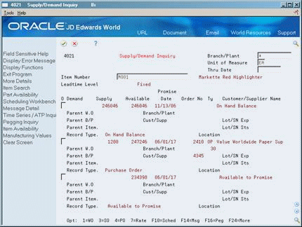

To review information for each location and lot, access the detail area.
Figure 14-2 Supply/Demand Inquiry screen (Detail area)
