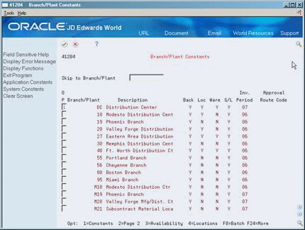

To define branch/plant constants
Figure 33-1 Branch/Plant Constants screen
Choose Constants (Option 1) to select a branch/plant.

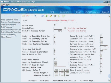

Figure 33-2 Branch/Plant Constants screen, page 1
On Branch/Plant Constants - Page 1, complete the following fields:
Branch/Plant
Brch/Plt Address Number (Branch/Plant Address Number)
To enter identification symbols for items in the branch/plant, complete the following fields:
Symbol to Identify Short No. (Symbol to Identify Short Number)
Symbol to Identify 2nd No. (Symbol to Identify Second Number)
Symbol to Identify 3rd No. (Symbol to Identify Third Number)
Symbol for Customer/Supplier
To enter cross-reference information for items in the branch/plant, complete the following fields:
Customer Cross Ref. Code (Customer Cross-Reference Code)
Supplier Cross Ref. Code (Supplier Cross-Reference Code)
To enter accounting information for items in the branch/plant, complete the following fields:
Current Inventory Period
Interface G/L (Y/N) (Interface General Ledger (Y/N))
General Ledger Explanation
Update Units to G/L (Update Units to General Ledger)
To enter cost information for items in the branch/plant, complete the following fields:
Purchase Order Issue Cost
Inventory Carrying Cost
Sales/Inventory Cost Method
Purchasing Costing Method
To enter commitment and sales information for items in the branch/plant, complete the following fields:
Commitment Method
Specific Commitment (Days)
Number of Days in Year
Approval Route Code
ABC Codes Sales
ABC Codes Margin
ABC Codes Average Investment % (ABC Codes Average Investment Percentage)
To complete the definitions for the branch/plant constants, complete the following fields:
Location Control (Y/N)
Warehouse Control (Y/N)
Foreign Depot
Quality Management (Y/N)
Branch/Plant Type
Item Branch Creation
Location Lot Creation
Enter A in the following field, and press Enter:
Action Code

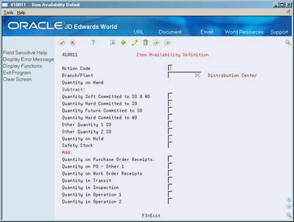

You must define how you want the system to calculate item availability for each branch/plant. This calculation impacts how the system calculates backorders, cancellations, and customer delivery time.
Enter 3 (Item Availability Definition) in the following field next to the branch plant:
Option
Figure 33-3 Item Availability Definition screen
On Item Availability Definition, enter a plus (+) or minus (-) sign in the following field to add or subtract from the appropriate quantity on hand.

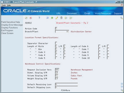

Defining the location format allows you to determine how to set up item locations. For example, assume that you store pencils in branch/plant A. You can define elements that contain more specific information about the actual location. For example, an element can represent an aisle, bin, shelf, or any other location that you use in a branch/plant.
You can define a location's format using up to 10 different elements, such as aisle, shelf, and bin. For each element, you can define the following:
Length
Justification
Separator character
If you are using the Advanced Warehouse Management system, you must also define default units of measure for volumes, dimensions, and weights.
Enter 2 (Page 2) in the following field:
Option
Figure 33-6 Branch/Plant Constants screen - page 2
On Branch/Plant Constants - Page 2, complete the following fields for each element:
Length (of Aisle, of Bin, of Code 3 - 10)
L/R (Left/Right)
Separator Character
This defines the location format.
| Field | Explanation |
| Length of Aisle | Identifies the number of characters to represent the tank (or aisle for packaged stock). Valid values are numbers 1 through 8. |
| L/R | Left or Right justification for Code 6 in the location format specification. |
| Separator Character | A character that divides the elements of the location when you display them on forms or reports. For example, you might use a slash (/) as a separator character to divide elements such as aisle, bin, and shelf in a location code.
Separators are not stored in the tables, but are used to edit a location on a form or report. If you do not want to use separators, leave this field blank. However, you must enter characters and spaces to equal the correct length of each element in the location code. The system then displays the location as one string of characters. Form-specific information The system uses the character you enter in this field to separate the combination of tank/owner and aisle/bin as it appears on forms or reports. Companies commonly use a period (.) as the separator character. |
| Topic | Description |
| Location length | The total length of all elements, including separators, cannot exceed 20 characters. The system does not store separators in the tables, but uses separators to edit a location on a form or report. If you do not want to use separators, leave the separator field blank. The system displays the location as one string of characters. |
