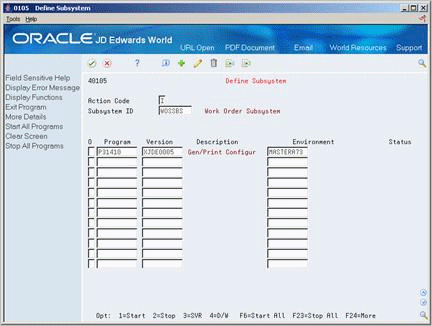

To use subsystem processing
On Define Subsystem
Figure 18-1 Define Subsystem screen
Description of Figure 18-1 follows
Description of "Figure 18-1 Define Subsystem screen"
