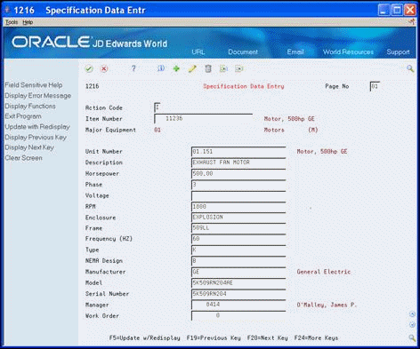

4.1 Entering Specification Information
Navigation
From Equipment/Plan Management (G13), choose Equipment Information
From Equipment Information (G1311), choose Supplemental Data
From Supplemental Data (G1318), choose Specification Data Entry
You can use the supplemental data type SP to include specification sheet information for your equipment. Use specification data to report on static equipment information. For example, you might set up this supplemental data type to record and report on the information from equipment nameplates and specification sheets.
Data Type Description
Equipment nameplates A nameplate is the metal plate that you attach to a piece of equipment. The nameplate often includes information about the equipment such as:
  • Model number
  • Power requirements
  • Manufacture date
Specification sheets Specification sheets come from the equipment manufacturer. Specification sheets include specific information about a piece of equipment such as:
  • Operating instructions
  • Safety instructions
  • Power
  • Dimensions
You set up and access the specification database as one of your supplemental data types. You can define what specification data you want to keep, in which positions you enter the data, and the length of the data fields. You can also set up the specification database so that the system will edit the data against user defined code tables.
4.1.1 Before You Begin
To enter specification information
  1. On Specification Data Entry, to locate a piece of equipment, complete the following field:
    Figure 4-1 Specification Data Entry screen
    Description of Figure 4-1 follows
    Description of "Figure 4-1 Specification Data Entry screen"
  2. Complete all appropriate fields.
  3. To see additional pages, complete the following field:
    • Page Number

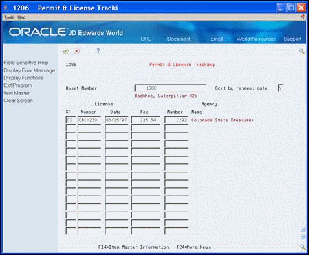

4.2 Entering Permit and License Information
Navigation
From Equipment Information (G1311), choose Permit and License Tracking
Enter permit and license information to record permits, licenses, and certificates for equipment. You can also track renewal dates and multiple state licenses. For example, you can track certification information for equipment, such as bridge cranes and license renewal information for equipment you transport to areas under different licensing authorities.
To enter permit and license information
  1. On Permit and License Tracking, to locate a piece of equipment, complete the following field.
    • Equipment Number (Asset Number)
  2. Complete the following fields:
    • State
    • Number
    • Date
    • Agency Number
  3. Complete the following optional field:
    • Fee
Figure 4-2 Permit and License Tracking screen
Description of Figure 4-2 follows
Description of "Figure 4-2 Permit and License Tracking screen"

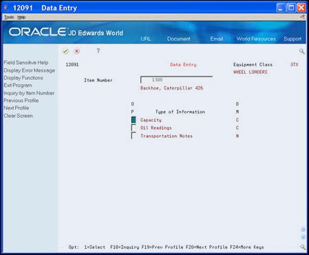

To enter supplemental information
  1. On Data Entry, to display a list of valid supplemental data types specific to a piece of equipment, complete the following field:
    • Equipment Number (Item Number)
    Figure 4-3 Data Entry screen
    Description of Figure 4-3 follows
    Description of "Figure 4-3 Data Entry screen"
  2. Select one or more types of information.

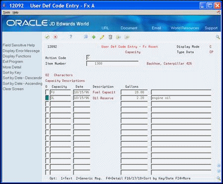

    The following example shows the format for data formats C and M.
    Figure 4-4 User Defined Code Entry screen showing data format
    Description of Figure 4-4 follows
    Description of "Figure 4-4 User Defined Code Entry screen showing data format"
  3. Complete the appropriate fields.

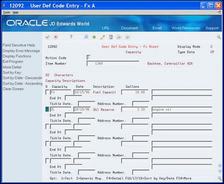

  4. Choose Detail (F4).
    Figure 4-5 User Defined Code Entry Detail screen
    Description of Figure 4-5 follows
    Description of "Figure 4-5 User Defined Code Entry Detail screen"
  5. To enter additional supplemental information, complete the appropriate fields.

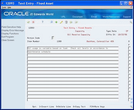

  6. To enter text for a specific line of code, select the Text option (C and M display formats only).
    Figure 4-6 Text Entry - Fixed Assets screen
    Description of Figure 4-6 follows
    Description of "Figure 4-6 Text Entry - Fixed Assets screen"

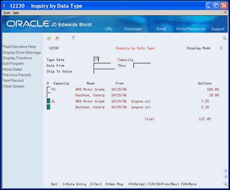

You can review a list of additional equipment information based on a particular supplemental data type. For example, assume you have set up a supplemental data type for capacity. You can review a list of all equipment for which you assign the supplemental data type for capacity. You can use date selections to limit the amount of information that the system displays.
To review supplemental information by data type
  1. On Inquiry by Data Type, complete the following field:
    • Type Data
    Figure 4-7 Inquiry by Data Type screen
    Description of Figure 4-7 follows
    Description of "Figure 4-7 Inquiry by Data Type screen"
  2. To limit the information that displays, complete the following optional fields:
    • Thru

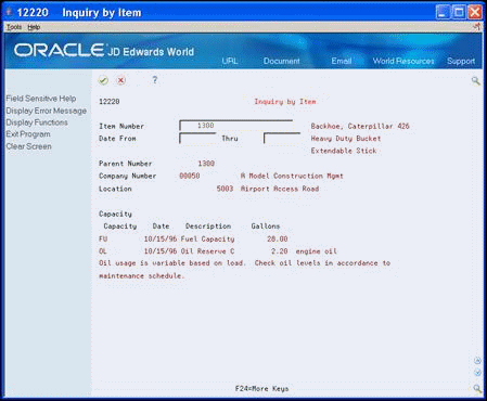

4.3.5 Reviewing Supplemental Information by Equipment
Navigation
From Supplemental Data (G1318), choose Inquiry by Item
You can review a list of the additional information by supplemental data type that you assign to individual pieces of equipment. For example, you can review information for all supplemental data types that you assign to a particular motor grader. You can use date selections to limit the amount of information that the system displays.
To review supplemental information by equipment
  1. On Inquiry by Item, complete the following field:
    • Equipment Number
    Figure 4-8 Inquiry by Item screen
    Description of Figure 4-8 follows
    Description of "Figure 4-8 Inquiry by Item screen"
    • Date From
    • Thru
