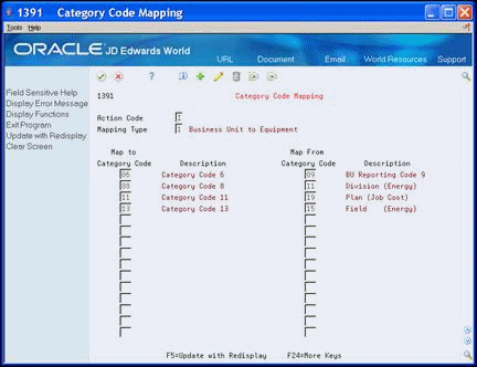

If you set up category codes for your business units that facilitate tracking and reporting on equipment, you can set up your system to automatically assign category codes from the responsible business unit to equipment category codes. When you enter master information for a new piece of equipment, the category codes that you specify from the responsible business unit automatically appear on the Equipment Master screen.
From Equipment/Plan Management (G13), enter 29
From Equipment/Plan Management Setup (G1341), choose Category Code Mapping
On Category Code Mapping, to indicate how you want to map the category codes, complete the following field:
Mapping Type
Complete the following fields:
Map to Category Code
Map From Category Code
| Field | Explanation |
| Mapping Type | Enter a 1 in this field to map Business Unit Category Codes to Equipment Category Codes.
Enter a 2 in this field to map Equipment Category Codes to Work Order Category Codes. |
| Map to Category Code | Use this field to specify defaults for your category codes. If the mapping type is 1, the equipment category code number in this field receives its default value from the Business Unit category code you specify in the Map From Category Code field on this form. If the mapping type is 2, the Work Order category code in this field receives its default value from the Equipment category code you specify in the Map From Category Code field. |
| Map From Category Code | Use this field to set up defaults for your category codes. If the mapping type is 1, the Business Unit category code value you enter in this field is the default value for the Equipment category code you specify in the Map To Category Code field on this form. If the mapping type is 2, the Equipment category code value you enter in this field is the default value for the Work Order category code you specify in the Map To Category Code field. |
