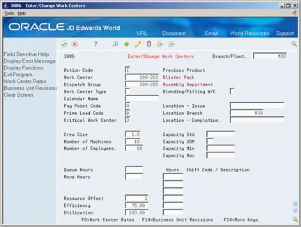

On Enter/Change Work Centers
Figure 8-1 Enter/Change Work Centers screen
Description of Figure 8-1 follows
Description of ''Figure 8-1 Enter/Change Work Centers screen''
  1. Complete the following field:
    • Work Center
  2. Complete the following optional fields:
    • Dispatch Group
    • Work Center Type
    • Calendar Name
    • Prime Load Code
    • Critical Work Center
    • Branch
    • Resource Offset
    • Efficiency
    • Utilization
