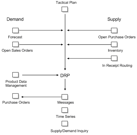

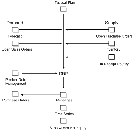

15.2.1 Master Scheduling Applications
DRP and Purchased Items
For distribution businesses, DRP provides centralized control of distribution inventories and creates a coordinated replenishment plan.
MPS and Manufactured Items
You use MPS to generate the master schedule for manufactured items. JD Edwards World systems plan replenishment for both purchased items and manufactured items in the same generation program. Processing options control how the system runs the generation.
