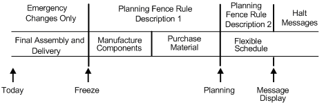

16.1 About Time Fences
Time fences are points in time in which you can make changes to either policy or operating procedures. JD Edwards World software includes three fences:
  • Freeze
  • Planning
  • Message Display
Fence Description
Freeze Fence (F) A freeze fence holds, or freezes, the master schedule. In doing so, the system does not generate any planned orders from the current date to the number of days set in the field. This enables the master scheduler to review the schedule and make adjustments manually if required. The system allows the schedule to be "frozen."
In addition, the system does not generate any messages that require action on existing work orders (such as an expedite message) within the frozen period of time. It displays warning action messages.
JD Edwards World recommends that you set this fence at a point in time in which you need to freeze the MPS, depending on the nature of your product and the nature of the business environment.
Planning Fence (P) A planning fence controls how the system uses the demand from forecast and customer orders in the ending available (EA) calculation. This fence also indicates where the method used to calculate ending available inventory changes from the demand rule in "Description 1" to "Description 2."
For planning purposes, JD Edwards World recommends that you set the planning fence at a point from the current date that equals at least 1-1/2 times the cumulative lead time. This will depend upon the business environment and the nature of the product. Once inside the planning fence, you have committed resources to the product line.
Message Display Fence (D) A message display fence suppresses action messages beyond the number of days that you selected from the current date. When you set this fence, calculations are not affected.
JD Edwards World recommends that you set the message display fence at the point in which you do not need to act on action messages, depending on the cumulative lead time of the product and the business environment.

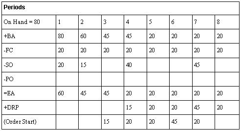

Example: Ending Available Calculation
Ending Available (EA) is the amount of product available at the end of a time bucket after the system calculates the effect of all supplies and all demands for the time bucket.
The system uses the planning time fence rule and the following formula to calculate the ending available amount:
  • Add within the time bucket:
    • Beginning Available (+BA)
    For the first weekly time period, +BA = quantity on hand - safety stock
    For remaining time periods, +BA = Ending Available from the previous time period (=EA)
  • Subtract according to the planning time fence rule:
    • Forecast (-FC)
    • Customer Demand (sales orders and interplant demand)
  • The remainder is the ending available (EA)
The following table shows how the system calculates the amount of product available at the end of a time period. Assume that the Lot Size = Lot for Lot, Planning Time Fence Rule = C.
Figure 16-2 Product Available at Period End
Description of Figure 16-2 follows
