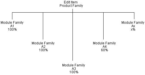

| Percent bill of material | Use a percent bill to express components as a percentage of parent item or process quantity. In this type of bill, the component or ingredient quantities are in direct proportion to each other. |
| Information bill of material | Use an information bill of material to view the bill of material online. These bills are also known as:
| Manufacturing bill of material | Use a manufacturing bill to document and track components. This type of bill is also known as:
A percent bill of material enables you to express component quantities as a percent of the parent item or process batch quantity.

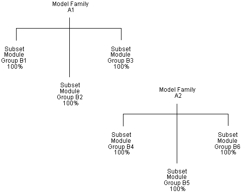

The manufacturing industry classifies bills of material by configuration, depending on the number of components and possible end items.
Figure 5-3 Bill of Material Configurations
| Profile | Description |
| Profile A | Few components produce few end item configurations |
| Profile B | Many components produce few end item configurations |
| Profile C | Few modules (made from many components) produce many end item configurations |
| Profile D | Few components produce many end item configurations |

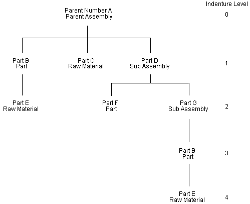

The following example shows a complex relationship of a parent item to components. Part B is both an independent part and part of the subassembly that makes up Part G.
Figure 5-5 Parent/Child Relationship in an Indented Bill of Material

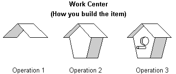

A work center consists of people and machines. It is a specific production facility on the shop floor where the routing operations occur. For each work center, you can define the following:
Number, description, and link to business unit
Queue and move times
Operator, machine, and hours per day capacity
Rates for set up, labor, machine, and overhead
In discrete manufacturing, examples of work centers include lathe, drill, heat treat, mill, and cut-off.
A work center enables you to:
Set up a dispatch group for departments that perform similar operations
Specify if an operation is a reporting point for material and or labor
Define crew size per work center
Specify the work center efficiency for Product Costing
Define work center labor, machine, and setup rates
The following graphic describes how work centers integrate with other manufacturing systems.
In this example, the same types of equipment are located in the same areas. Work in process moves from one area to the next. This functional layout provides an indirect path which might produce bottlenecks in the work flow.
In this example, equipment is grouped by operations. This structured flow layout provides a direct path and ensures efficient work flow.
