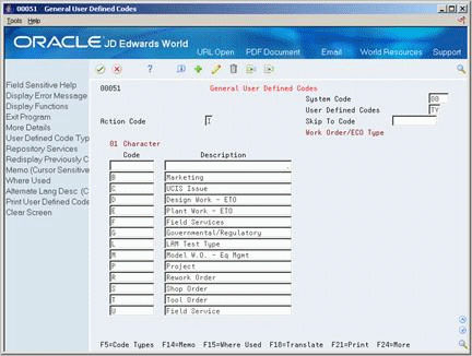

To set up type codes
You can set up user defined codes (table 00/TY) to define types of ECOs such as G for government or R for rework.
On Type Code
Figure 12-2 General User Defined Codes screen, Work Order/ECO Type field
Description of Figure 12-2 follows
Description of "Figure 12-2 General User Defined Codes screen, Work Order/ECO Type field"
Complete the following fields:
  • Code
  • Description
  • Description 2

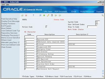

To set up status codes
Navigation
From Product Data Management (G30), enter 29
From Product Data Management Setup (G3041), choose Status Code
You can set up user defined codes (table 00/SS) to define the status of ECOs such as EM for emergency and A for approved.
On Status Code
Figure 12-4 Status Code screen
Description of Figure 12-4 follows
Description of "Figure 12-4 Status Code screen"
  • Code
  • Description

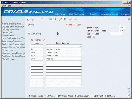

To set up phase in codes
Navigation
From Product Data Management Setup (G3041), choose Phase In Code
You can set up user defined codes (table 00/PH) to define how to phase in ECOs such as IMD for immediate and AVL for as available.
On Phase In Code
Figure 12-5 Phase In Code screen
Description of Figure 12-5 follows
Description of "Figure 12-5 Phase In Code screen"
  • Code
  • Description

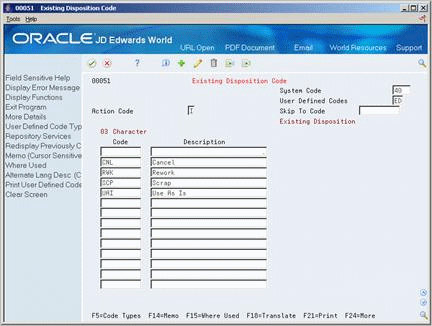

To set up existing disposition codes
Navigation
From Product Data Management Setup (G3041), choose Existing Disposition Codes
On Existing Disposition Code
Figure 12-6 Existing Disposition Code screen
Description of Figure 12-6 follows
Description of "Figure 12-6 Existing Disposition Code screen"
  • Code
  • Description
You can set up user defined codes (table 00/ED) to define what to do with existing items that are affected by the ECO, such as CNL for cancel and RWK for rework.

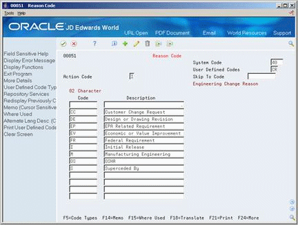

To set up reason codes
Navigation
From Product Data Management Setup (G3041), choose Reason Codes
You can set up user defined codes (table 40/CR) reasons for defining ECOs such as CC for customer change and FR for federal requirements.
On Reason Code
Figure 12-7 Reason Code screen
Description of Figure 12-7 follows
Description of "Figure 12-7 Reason Code screen"
  • Code
  • Description

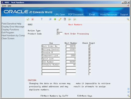

12.2 Setting Up Next Numbers for Engineering Change Orders
Navigation
From Product Data Management Setup (G3041), choose Next Numbers
Next numbers is an automatic document numbering feature. It allows you to enter a starting document number for each document type such ECOs. If you do not assign an ECO number manually, the system automatically assigns the next number to the ECO.
You can also use a check digit. This is an additional number that the system attaches to the end of the next number. Check digits prevent transpositions and data entry errors. Check digits are not sequential.
Caution:
If you change the numbering scheme, you should change the next number to a value that is greater than the previously assigned numbers.
Figure 12-8 Next Numbers screen
Description of Figure 12-8 follows
Description of "Figure 12-8 Next Numbers screen"
To set up next numbers for engineering change orders:
  1. Locate next numbers for system 48 Work Order Processing.
  2. For ECO Number, complete the following fields:
    • Next Number
    • Check Digit
See Also:
Field Explanation
Next Number The next number which will automatically be assigned by the system. Next numbers can be used for many types of documents including voucher numbers, invoice numbers, journal entry numbers, employee numbers, address numbers and so on. Next numbers can be reviewed from the Operations Control Menu. You must adhere to the next numbers that have been pre-established unless custom programming has been provided.
Check Digit A number that prevents the Next Numbers program (P0002) from assigning transposed numbers. If you use check digits, the system automatically adds a number to the end of each number that it assigns through Next Numbers.

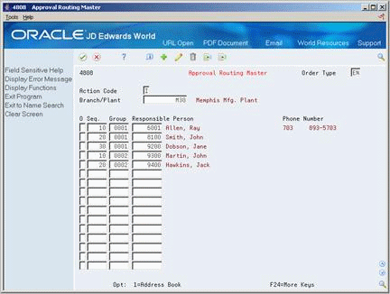

12.3 Setting Up Approval Routings
Use an approval routing to maintain a list of reviewers by that should receive an electronic mail notification of pending ECOs.
You can set up two types of approval routing. The approval routing master applies to a specific branch/plant and order type combination. Order specific approval routing applies to a specific ECO. After you have set up an approval routing master for your branch/plant, you can customize the routing for a specific ECO.
Setting up approval routings consists of the following tasks:
  • Setting up an approval routing master
  • Setting up an order specific routing (optional)
12.3.1 To set up approval routings
Navigation
From Product Data Management (G30), choose Engineering Change Management
From Engineering Change Management (G3013), choose Approval Routing Master
On Approval Routing Master
Figure 12-9 Approval Routing Master screen
Description of Figure 12-9 follows
Description of "Figure 12-9 Approval Routing Master screen"
  • Branch/Plant
  • Sequence Number
  • Group
  • Responsible Person

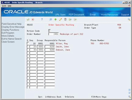

12.3.2 To set up an order-specific approval routing
Navigation
From Engineering Change Management (G3013), choose Order Specific Routing
On Order Specific Routing
Figure 12-10 Order Specific Routing screen
Description of Figure 12-10 follows
Description of "Figure 12-10 Order Specific Routing screen"
  • Order Number
  • Group
  • Sequence
12.3.3 What You Should Know About
Topic Description
Assigning reviewers to groups The system notifies all reviewers in a group at the same time. The system notifies the groups in the order that they are defined within the user defined code. The codes do not have to be numeric. The system waits to send notification to a group until all members in the prior group have approved the ECO.
Deleting an approval list When you delete an approval list, the system prompts you to confirm the deletion.
