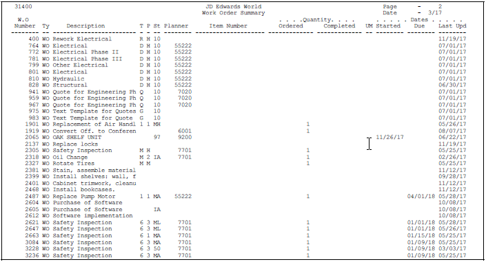

From Shop Floor Control (G31), choose Discrete Daily Order Preparation.
From Periodic Functions - Discrete (G3121), choose Work Order Summary
The Work Order Summary report lists selected work orders in the Work Order Master table (F4801). You can use this report to review work orders in your system. The report shows the planner ID, item number, order quantity, completed quantity, and start and due dates.
